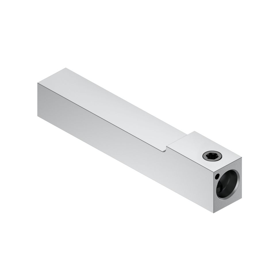

KM-CM-HPC • Square Shank • KM Micro™ Clamping Units
Square Shank
Material Number3134824
ISO Catalog IDKM16LCM10400HPCANSI Catalog IDKM16LCM10400HPC
KM Micro™ Clamping Units Square Shank
$348.47/each
  • Shank - KM MicroShank - KM Micro
Drawings for 3134824
[CSWS] System Size Workpiece SideKM16
[B] Shank Width 15.75 mm
[B] Shank Width 0.62 in
[H] Shank Height 15.75 mm
[H] Shank Height 0.62 in
[H1] Centerline Height 7.875 mm
[H1] Centerline Height 0.31 in
[F] F Dimension 10 mm
[F] F Dimension 0.394 in
[L1] Gage Length101.6 mm
[L1] Gage Length4 in
[CS] Coolant Supply Size1/8 NPT
Actuation Screw ID Drive Size27 IP
Torque Newton Meters10-11
