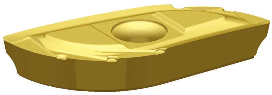

XPNT-F • Stellram
Indexable Inserts
Material Number5653063
ISO Catalog IDXPNT121254RFANSI Catalog IDXPNT121254RF
- P Steel
- M Stainless Steel
- S High-Temp Alloys
Material Number | 5653063 |
ISO Catalog ID | XPNT121254RF |
ANSI Catalog ID | XPNT121254RF |
Grade | SP6519 |
[D] Insert IC Size | 17 mm |
[D] Insert IC Size | 0.669 in |
[LI] Insert Length | 39.99 mm |
[LI] Insert Length | 1.574 in |
[S] Insert Thickness | 7.95 mm |
[S] Insert Thickness | 0.313 in |
[RC] Corner Radius Center | 19.491 mm |
[RC] Corner Radius Center | 0.7673 in |
Average Chip Thickness [HM] | 0.04 mm |
Average Chip Thickness [HM] | 0.0016 in |
- Steel
- Stainless Steel
- High-Temp Alloys
SP6519
Coated carbide grade with PVD TiAlN nano-composite coating on a tough substrate. Primarily for use in general and heavy machining, dry and wet.
