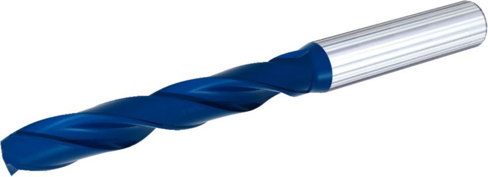

SHD_301HA/SHD_501HA • 3 x D/5 x D • Metric
Stellram® HardCore® Drill • Without Coolant
Material Number5654207
ISO Catalog IDSHD0397/0.156/501HAANSI Catalog IDSHD0397/0.156/501HA
Drilling
DIN number 6535
DIN number 6537
Flood Coolant: Drilling
Shank - Cylindrical Plain ≤h6
Helix Angle: 30°
| Material Number | 5654207 |
| ISO Catalog ID | SHD0397/0.156/501HA |
| ANSI Catalog ID | SHD0397/0.156/501HA |
| Grade | HCT600 |
| Engineering Tool Family | SHD_501_H_ |
| [D1] Drill Diameter M | 3.97 mm |
| [D1] Drill Diameter M | 0.1563 in |
| [L5] Drill Point Length | 0.722 mm |
| [L5] Drill Point Length | 0.0284 in |
| [LS] Shank Length | 36 mm |
| [LS] Shank Length | 1.417 in |
| [D] Adapter / Shank / Bore Diameter | 6 mm |
| [D] Adapter / Shank / Bore Diameter | 0.236 in |
| [L] Overall Length | 74 mm |
| [L] Overall Length | 2.913 in |
| [L3] Flute Length | 36 mm |
| [L3] Flute Length | 1.417 in |
| [L4] Maximum Drilling Depth | 29 mm |
| [L4] Maximum Drilling Depth | 1.142 in |
Drilling
DIN number 6535
DIN number 6537
Helix Angle: 30°
HCT600
Composition: PVD TiAlN coated dual-layer fine-grain carbide.
Application: Applicable in steel, cast iron, and hardened materials. This grade perfectly combines a tough substrate in the core to improve toughness and shock resistance at the drill center where circumferential speeds are low with a harder substrate as case material for optimized wear resistance towards the cutting corner where circumferential speeds are high.
- Stellram® HardCore® drill for tough materials.
- Material-specific SC drill made of dual grade.
- Outer carbide grade for high speeds with high wear-resistant properties.
- Core carbide grade for low speeds with excellent toughness and shock-resistant properties.
- Operate this drill with flood coolant in P3 and P4 steels with a tensile strength up to 1400 MPa and H1 and H2 hardened materials with hardness up to 55 HRC.
- Accurate ground edge preparation enables reduced bur formation.
