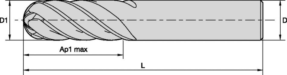

HARVI™ III • 球头铣刀 • 6 刃 • 直柄 • 英制
HARVI™ III 整体硬质合金立铣刀,用于 3D 仿形加工,具有最高的生产率
物料号100015090
通用表示形式
请联系我们的销售人员来了解您的定价。
- Versatile solid carbide end mill for steels, stainless steel and high-temperature alloys
- HARVI™ III solid carbide end mills cover a variety of operations
- HARVI™ III solid carbide end mills feature unequal flute spacing for chatter-free machining at highest feed rates
- Eccentric relief grind for higher edge stability and higher feed rates
- Center cutting for plunging and ramping operations
Ball Nose Trochoidal Milling
侧铣/方肩铣削: 球形刀尖
3D仿形加工
刀具尺寸: 排屑槽数: 6
螺旋角: 38°
