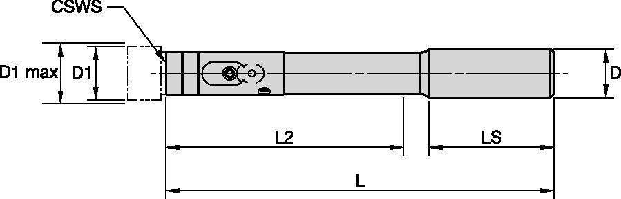

Drawings for 3861202
Material Number3861202
ISO Catalog IDSS25KST250RR5M
ANSI Catalog IDSS25KST250RR5M
[CSWS] System Size Workpiece SideKST250
[D1] Adapter / Shank / Bore Diameter27.5 mm
[D1] Adapter / Shank / Bore Diameter1.083 in
[D1MAX] Maximum Adaptor/Bore Diameter32.499 mm
[D1MAX] Maximum Adaptor/Bore Diameter1.2795 in
[D] Adapter / Shank / Bore Diameter25 mm
[D] Adapter / Shank / Bore Diameter0.984 in
[L] Overall Length 217.5 mm
[L] Overall Length 8.563 in
[L2] Usable Length 145.5 mm
[L2] Usable Length 5.728 in
[LS] Shank Length 56 mm
[LS] Shank Length 2.205 in
  • Tool body shipped with retention knob, clamp set, and wrench.
  • Order reamer head separately.
