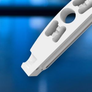

BN6000 – Advanced Boron Nitride for High-Temperature and Aerospace Applications
BN6000 is an advanced hot-pressed boron nitride material engineered for demanding industrial and aerospace applications. With a unique formulation, it delivers superior mechanical properties compared to other pure BN grades, all while maintaining outstanding performance in plasma environments and under extreme temperatures.
This makes BN6000 the ideal choice for components exposed to high temperatures and vacuum conditions, positioning it as an essential material for high-temperature and space applications.
