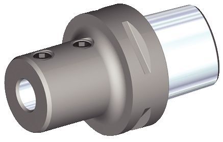

BAI Boring Bar Adapter Internal Coolant Only • Metric
Boring Bar Adapters
Material Number4099182
ISO Catalog IDPSC63BAI32075MANSI Catalog IDPSC63BAI32075M
BAI-PSC63 Metric Tool Holders & Adapters - 4099182 - Kennametal
$748.52/each
  • Manufacturer’s Specs: ISO 26623Manufacturer’s Specs: ISO 26623
  • Shank - PSCShank - PSC
  • Shank - Cylindrical with FlatShank - Cylindrical with Flat
  • Coolant: Through Coolant 80 bar MaximumCoolant: Through Coolant 80 bar Maximum
  • Coolant: Through Coolant 1200 psi MaximumCoolant: Through Coolant 1200 psi Maximum
Drawings for 4099182
[D1] Adapter / Shank / Bore Diameter32 mm
[D1] Adapter / Shank / Bore Diameter1.26 in
[D2] Body Diameter 1 Workpiece Side 63 mm
[D2] Body Diameter 1 Workpiece Side 2.48 in
[L1] Gage Length75 mm
[L1] Gage Length2.953 in
[L9] Clamping Length 55 mm
[L9] Clamping Hole Length 2.165 in
Torque Newton Meters35
Weight Kilograms1.68
