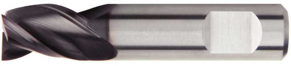

GOmill™ • Square End • 3 Flutes • Weldon® Shank • Metric
Solid Carbide End Mill for Roughing and Finishing of Multiple Materials
Material Number4032796
ISO Catalog IDUEDE0800B3ASANSI Catalog IDUEDE0800B3AS

  • Tool Dimensions: Flute Configuration: 3Tool Dimensions: Flute Configuration: 3
Drawings for 4032796
GradeKC643M
Adapter Style Machine SideWeldon Short
[D1] Effective Cutting Diameter8 mm
[D1] Effective Cutting Diameter0.315 in
[D] Adapter / Shank / Bore Diameter8 mm
[D] Adapter / Shank / Bore Diameter0.315 in
[AP1MAX] 1st Maximum Cutting Depth11 mm
[AP1MAX] 1st Maximum Cutting Depth0.433 in
[L3] Usable Length11 mm
[L3] Usable Length0.433 in
[L] Overall Length 43 mm
[L] Overall Length 1.693 in
[Z] Number of Flutes3
KC643M
KC643M
Coated fine-grain grade with PVD multilayer (AlTiN). KC643M™ is a very thin and hard PVD coating particularly suited for cutting steel, cast iron, stainless steel (wet), and titanium (wet). This grade can be used for materials with hardness up to 52 HRC.
  • Economic solid carbide end mill with short style shanks, saving expensive carbide.
  • Not recommended for reconditioning.
  • Extremely stable cutting conditions due to short design.
  • Center cutting for plunging and ramping operations.
  • Unequal flute spacing for chatter-free machining at highest feed rates.
