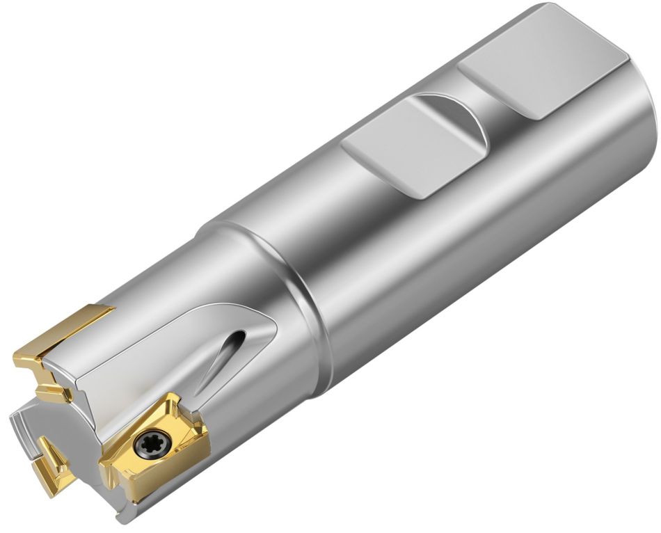

Mill 4-11™ • End Mill • Weldon Shank • Metric
Shoulder Milling • End Mill • Weldon Shank
Material Number100068796
- Shoulder milling cutter.
- Superior wall and surface finish capabilities.
- True 90° capabilities. Stepless solution when using multiple steps.
- Engineered to run up to .433″ (11mm) depth of cut.
- Effective internal coolant feature, reaching the cutting edge precisely.
Face Milling
Slotting: Square End
Shank - Cylindrical Weldon
Milling - Through Coolant
