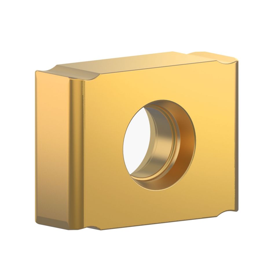

Narrow Slotting LN Series • Carbide Insert• LNEU-R • Light Machining
Narrow Slotting LN Series • Carbide Insert• LNEQ-R • Heavy Machining
Narrow Slotting LN Series • Carbide Insert• LNEU-SGP • Medium Machining
