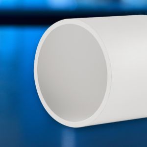

BN9000 is a medium-density hexagonal boron nitride (hBN) grade that utilizes innovative near-net shape forming and pressure-less sintering technology. This advanced manufacturing process allows for the creation of large components up to 400mm x 310mm x 50mm, significantly reducing the need for extensive machining and material waste. The large size capability and excellent properties make BN9000 an outstanding choice for furnace setters and other applications requiring the benefits of hBN.
