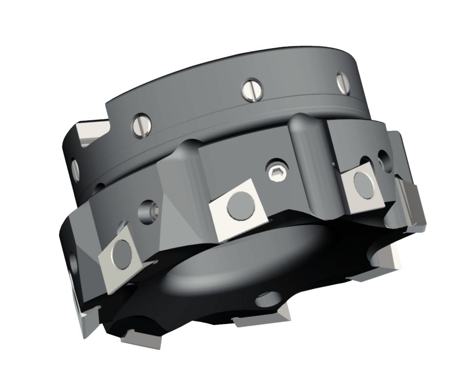

Fix-Perfect™ 90° • Aluminium • Shell Mills • M Line • Metric
Material Number2210826
ISO Catalog ID40A02RP90BG15CMANSI Catalog ID40A02RP90BG15CM
Fix-Perfect™ 90° - Aluminium - Shell Mills - M Line - Metric 2210826 - Kennametal
$575.50/each
  • Face MillingFace Milling
Drawings for 2210826
[D1] Effective Cutting Diameter40 mm
[D1] Effective Cutting Diameter1.5748 in
[D] Adapter / Shank / Bore Diameter16 mm
[D] Adapter / Shank / Bore Diameter0.6299 in
[D6] Hub Diameter 35.4 mm
[D6] Hub Diameter 1.3937 in
[L] Overall Length 40 mm
[L] Overall Length 1.575 in
[AP1MAX] 1st Maximum Cutting Depth9.5 mm
[AP1MAX] 1st Maximum Cutting Depth0.374 in
Number of Inserts2
Weight Kilograms0.2
Max RPM15920
  • Excellent for milling aluminium and non-ferrous materials.
  • Good choice for thin wall or poorly fixtured workpieces.
  • 24° positive rake provides free cutting action.
  • Produces excellent finish and flatness.
  • Maximum speed is 2000 m/min.
  • All pockets are fixed pockets.
