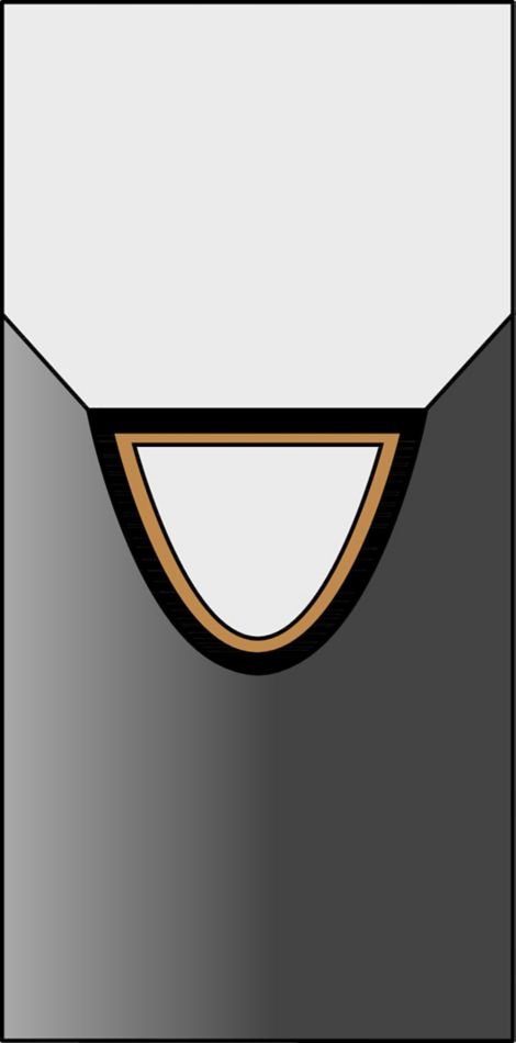

KCPK05
KCPK05
Composition: A deformation-resistant, cobalt-enriched substrate combined with thick MTCVD TiCN-Al2O3 coating.
Application: For high productivity turning of steels and PH stainless steels in continuous to lightly interrupted cuts. This grade provides excellent combination of toughness and high speed wear resistance allowing the fastest steel part production. Its unique combination of substrate and coating also make it an ideal roughing grade for cast iron where chipping resistance is required.
