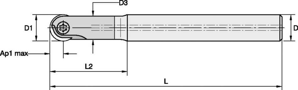

Drawings for 2879404
Material Number2879404
ISO Catalog IDKDMB0375R591A038HNC
ANSI Catalog IDKDMB0375R591A038HNC
[D1] Effective Cutting Diameter9.525 mm
[D1] Effective Cutting Diameter0.375 in
[D] Adapter / Shank / Bore Diameter9.525 mm
[D] Adapter / Shank / Bore Diameter0.375 in
[D3] Neck Diameter 8.89 mm
[D3] Neck Diameter 0.35 in
[L] Overall Length 150 mm
[L] Overall Length 5.91 in
[L2] Head Length 48.263 mm
[L2] Head Length 1.9001 in
[AP1MAX] 1st Maximum Cutting Depth4.763 mm
[AP1MAX] 1st Maximum Cutting Depth0.1875 in
Number of Inserts1
[Z] Number of Flutes2
Coolant SupplyY
Maximum Ramping Angle3
Max RPM30000
Gage InsertKDMB0375.
Weight Pounds0.28
