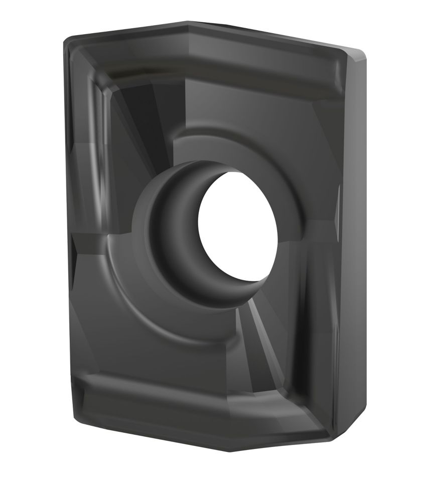

KSEM PLUS™ • Outboard Insert • DFR-GD Geometry
Modular Drilling • Carbide Insert for KSEM PLUS™ A1 Heads
Material Number5067486
ISO Catalog IDDFR040304D28GDANSI Catalog IDDFR040304D28GD
- P Steel
- K Cast Iron
Material Number | 5067486 |
ISO Catalog ID | DFR040304D28GD |
ANSI Catalog ID | DFR040304D28GD |
Grade | KCU25 |
[LI] Insert Length | 10.759 mm |
[LI] Insert Length | 0.4236 in |
[W] Insert Width | 7.26 mm |
[W] Insert Width | 0.286 in |
[D1] Insert Hole Size | 2.85 mm |
[D1] Insert Hole Size | 0.1122 in |
[S] Insert Thickness | 3.79 mm |
[S] Insert Thickness | 0.1492 in |
[Rε] Corner Radius | 0.4 mm |
[Rε] Corner Radius | 0.016 in |
- Steel
- Cast Iron
KCU25
Composition: An advanced PVD grade with hard AlTiN coating and fine-grain unalloyed substrate. The new and improved coating improves edge stability with wide range speed and feed capabilities.
Application: The KCU25™ grade is ideal for general machining of most steels, stainless steels, high-temp alloys, titanium, irons, and non-ferrous materials in a wide range of speeds and feeds with improved edge toughness for interrupted cuts and high feed rates.
- Drilling insert for primary application in steels, cast iron and high temperature alloys
- Two cutting edges
- Outboard insert for diameter range 28-31,74mm (1.102-1.249")

U | 197 | 361 | 525 | IPR | 0.007–0.012 | 0.007–0.012 | 0.009–0.014 | 0.009–0.017 | 0.012–0.019 | ||
I | 131 | 230 | 328 | IPR | 0.007–0.012 | 0.007–0.012 | 0.009–0.014 | 0.009–0.017 | 0.012–0.019 | ||
3 | S | 295 | 492 | 689 | IPR | 0.007–0.012 | 0.007–0.012 | 0.009–0.014 | 0.009–0.017 | 0.012–0.019 | |
U | 197 | 328 | 492 | IPR | 0.007–0.012 | 0.007–0.012 | 0.009–0.014 | 0.009–0.017 | 0.012–0.019 | ||
I | 115 | 197 | 295 | IPR | 0.007–0.012 | 0.007–0.012 | 0.009–0.014 | 0.009–0.017 | 0.012–0.019 | ||
N | 1 | S | 492 | 787 | 1181 | IPR | 0.005–0.008 | 0.005–0.008 | 0.006–0.011 | 0.006–0.013 | 0.008–0.016 |
U | 328 | 525 | 787 | IPR | 0.005–0.008 | 0.005–0.008 | 0.006–0.011 | 0.006–0.013 | 0.008–0.016 | ||
I | 197 | 328 | 525 | IPR | 0.005–0.008 | 0.005–0.008 | 0.006–0.011 | 0.006–0.013 | 0.008–0.016 | ||
2 | S | 492 | 722 | 1181 | IPR | 0.005–0.008 | 0.005–0.008 | 0.006–0.011 | 0.006–0.013 | 0.008–0.016 | |
U | 328 | 492 | 787 | IPR | 0.005–0.008 | 0.005–0.008 | 0.006–0.011 | 0.006–0.013 | 0.008–0.016 | ||
3 | S | 492 | 722 | 1181 | IPR | 0.005–0.008 | 0.005–0.008 | 0.006–0.011 | 0.006–0.013 | 0.008–0.016 | |
4 | S | 492 | 722 | 1181 | IPR | 0.005–0.008 | 0.005–0.008 | 0.006–0.011 | 0.006–0.013 | 0.008–0.016 | |
5 | S | 492 | 722 | 1181 | IPR | 0.005–0.008 | 0.005–0.008 | 0.006–0.011 | 0.006–0.013 | 0.008–0.016 | |
6 | S | 492 | 656 | 1181 | IPR | 0.005–0.008 | 0.005–0.008 | 0.006–0.011 | 0.006–0.013 | 0.008–0.016 | |
U | 328 | 459 | 787 | IPR | 0.005–0.008 | 0.005–0.008 | 0.006–0.011 | 0.006–0.013 | 0.008–0.016 | ||
I | 197 | 295 | 525 | IPR | 0.005–0.008 | 0.005–0.008 | 0.006–0.011 | 0.006–0.013 | 0.008–0.016 | ||
7 | S | 361 | 722 | 853 | IPR | 0.005–0.008 | 0.005–0.008 | 0.006–0.011 | 0.006–0.013 | 0.008–0.016 | |
U | 230 | 459 | 558 | IPR | 0.005–0.008 | 0.005–0.008 | 0.006–0.011 | 0.006–0.013 | 0.008–0.016 | ||
I | 148 | 295 | 361 | IPR | 0.005–0.008 | 0.005–0.008 | 0.006–0.011 | 0.006–0.013 | 0.008–0.016 | ||
S | 1 | S | 82 | 164 | 246 | IPR | 0.005–0.010 | 0.005–0.010 | 0.006–0.011 | 0.006–0.013 | 0.008–0.014 |
U | 66 | 131 | 197 | IPR | 0.005–0.010 | 0.005–0.010 | 0.006–0.011 | 0.006–0.013 | 0.008–0.014 | ||
I | 49 | 98 | 164 | IPR | 0.005–0.010 | 0.005–0.010 | 0.006–0.011 | 0.006–0.013 | 0.008–0.014 | ||
2 | S | 66 | 131 | 197 | IPR | 0.005–0.010 | 0.005–0.010 | 0.006–0.011 | 0.006–0.013 | 0.008–0.014 | |
U | 49 | 98 | 148 | IPR | 0.005–0.010 | 0.005–0.010 | 0.006–0.011 | 0.006–0.013 | 0.008–0.014 | ||
I | 39 | 82 | 115 | IPR | 0.005–0.010 | 0.005–0.010 | 0.006–0.011 | 0.006–0.013 | 0.008–0.014 | ||
3 | S | 66 | 131 | 197 | IPR | 0.005–0.010 | 0.005–0.010 | 0.006–0.011 | 0.006–0.013 | 0.008–0.014 | |
I | 39 | 82 | 131 | IPR | 0.005–0.010 | 0.005–0.010 | 0.006–0.011 | 0.006–0.013 | 0.008–0.014 | ||
4 | S | 66 | 131 | 197 | IPR | 0.005–0.010 | 0.005–0.010 | 0.006–0.011 | 0.006–0.013 | 0.008–0.014 | |
Metric | |||||||||||
Condition | Cutting Speed | ||||||||||
Range | Recommended Feed Rate (fz) by Diameter | ||||||||||
Material | Min | Starting Value | Max | Ø | KSEM 14….17 DFR/DFC04... 28,00 | KSEM 15….18 DFT/DFC05… 31,75 | KSEM 13….22 DFT/DFC06... 36,00 | KSEM 18….28 DFT/DFC07... 45,00 | KSEM 20….34 DFT/DFC09... 56,00 | ||
P | 1 | S | 115 | 235 | 290 | mm/dev | 0,130–0,250 | 0,130–0,250 | 0,160–0,280 | 0,160–0,320 | 0,200–0,360 |
U | 90 | 160 | 215 | mm/dev | 0,130–0,250 | 0,130–0,250 | 0,160–0,280 | 0,160–0,320 | 0,200–0,360 | ||
I | 65 | 100 | 140 | mm/dev | 0,130–0,250 | 0,130–0,250 | 0,160–0,280 | 0,160–0,320 | 0,200–0,360 | ||
2 | S | 90 | 190 | 230 | mm/dev | 0,160–0,280 | 0,160–0,280 | 0,200–0,360 | 0,200–0,400 | 0,200–0,450 | |
U | 71 | 130 | 170 | mm/dev | 0,160–0,280 | 0,160–0,280 | 0,200–0,360 | 0,200–0,400 | 0,200–0,450 | ||
I | 50 | 80 | 110 | mm/dev | 0,160–0,280 | 0,160–0,280 | 0,200–0,320 | 0,200–0,400 | 0,200–0,450 | ||
3 | S | 90 | 180 | 230 | mm/dev | 0,160–0,280 | 0,160–0,280 | 0,200–0,320 | 0,200–0,400 | 0,200–0,450 | |
U | 70 | 120 | 170 | mm/dev | 0,160–0,280 | 0,160–0,280 | 0,200–0,320 | 0,200–0,400 | 0,200–0,450 | ||
I | 50 | 70 | 106 | mm/dev | 0,160–0,280 | 0,160–0,280 | 0,200–0,320 | 0,200–0,400 | 0,200–0,450 | ||
4 | S | 90 | 140 | 220 | mm/dev | 0,160–0,280 | 0,160–0,280 | 0,200–0,320 | 0,200–0,400 | 0,200–0,450 | |
U | 70 | 110 | 160 | mm/dev | 0,160–0,280 | 0,160–0,280 | 0,200–0,320 | 0,200–0,400 | 0,200–0,450 | ||
5 | S | 90 | 130 | 210 | mm/dev | 0,160–0,280 | 0,160–0,280 | 0,200–0,320 | 0,200–0,400 | 0,200–0,450 | |
U | 70 | 100 | 150 | mm/dev | 0,160–0,280 | 0,160–0,280 | 0,200–0,320 | 0,200–0,400 | 0,200–0,450 | ||
I | 50 | 70 | 100 | mm/dev | 0,160–0,280 | 0,160–0,280 | 0,200–0,320 | 0,200–0,400 | 0,200–0,450 | ||
6 | S | 70 | 90 | 180 | mm/dev | 0,160–0,280 | 0,160–0,280 | 0,200–0,320 | 0,200–0,400 | 0,200–0,450 | |
U | 50 | 75 | 120 | mm/dev | 0,160–0,280 | 0,160–0,280 | 0,200–0,320 | 0,200–0,400 | 0,200–0,450 | ||
I | 40 | 60 | 100 | mm/dev | 0,160–0,280 | 0,160–0,280 | 0,200–0,320 | 0,200–0,400 | 0,200–0,450 | ||
M | 1 | S | 60 | 110 | 135 | mm/dev | 0,130–0,250 | 0,130–0,250 | 0,160–0,280 | 0,160–0,320 | 0,200–0,360 |
U | 40 | 70 | 90 | mm/dev | 0,130–0,250 | 0,130–0,250 | 0,160–0,280 | 0,160–0,320 | 0,200–0,360 | ||
I | 30 | 50 | 65 | mm/dev | 0,130–0,250 | 0,130–0,250 | 0,160–0,280 | 0,160–0,320 | 0,200–0,360 | ||
2 | S | 60 | 100 | 135 | mm/dev | 0,130–0,250 | 0,130–0,250 | 0,160–0,280 | 0,160–0,320 | 0,200–0,360 | |
U | 40 | 60 | 90 | mm/dev | 0,130–0,250 | 0,130–0,250 | 0,160–0,280 | 0,160–0,320 | 0,200–0,360 | ||
3 | S | 50 | 90 | 135 | mm/dev | 0,130–0,250 | 0,130–0,250 | 0,160–0,280 | 0,160–0,320 | 0,200–0,360 | |
I | 25 | 40 | 65 | mm/dev | 0,130–0,250 | 0,130–0,250 | 0,160–0,280 | 0,160–0,320 | 0,200–0,360 | ||
K | 1 | S | 90 | 170 | 230 | mm/dev | 0,180 - 0,300 | 0,180 - 0,300 | 0,216 - 0,360 | 0,240 - 0,420 | 0,300 - 0,480 |
U | 60 | 120 | 160 | mm/dev | 0,180–0,300 | 0,180–0,300 | 0,216–0,360 | 0,240–0,420 | 0,300–0,480 | ||
I | 40 | 70 | 90 | mm/dev | 0,180 - 0,300 | 0,180 - 0,300 | 0,216 - 0,360 | 0,240 - 0,420 | 0,300 - 0,480 | ||
2 | S | 90 | 160 | 220 | mm/dev | 0,180–0,300 | 0,180–0,300 | 0,216–0,360 | 0,240–0,420 | 0,300–0,480 | |
U | 60 | 110 | 160 | mm/dev | 0,180 - 0,300 | 0,180 - 0,300 | 0,216 - 0,360 | 0,240 - 0,420 | 0,300 - 0,480 | ||
I | 40 | 70 | 100 | mm/dev | 0,180–0,300 | 0,180–0,300 | 0,216–0,360 | 0,240–0,420 | 0,300–0,480 | ||
3 | S | 90 | 150 | 210 | mm/dev | 0,180 - 0,300 | 0,180 - 0,300 | 0,216 - 0,360 | 0,240 - 0,420 | 0,300 - 0,480 | |
U | 60 | 100 | 150 | mm/dev | 0,180–0,300 | 0,180–0,300 | 0,216–0,360 | 0,240–0,420 | 0,300–0,480 | ||
I | 35 | 60 | 90 | mm/dev | 0,180 - 0,300 | 0,180 - 0,300 | 0,216 - 0,360 | 0,240 - 0,420 | 0,300 - 0,480 | ||
N | 1 | S | 150 | 240 | 360 | mm/dev | 0,120–0,200 | 0,120–0,200 | 0,144–0,280 | 0,160–0,320 | 0,200–0,400 |
U | 100 | 160 | 240 | mm/dev | 0,120–0,200 | 0,120–0,200 | 0,144–0,280 | 0,160–0,320 | 0,200–0,400 | ||
I | 60 | 100 | 160 | mm/dev | 0,120–0,200 | 0,120–0,200 | 0,144–0,280 | 0,160–0,320 | 0,200–0,400 | ||
2 | S | 150 | 220 | 360 | mm/dev | 0,120–0,200 | 0,120–0,200 | 0,144–0,280 | 0,160–0,320 | 0,200–0,400 | |
U | 100 | 150 | 240 | mm/dev | 0,120–0,200 | 0,120–0,200 | 0,144–0,280 | 0,160–0,320 | 0,200–0,400 | ||
3 | S | 150 | 200 | 360 | mm/dev | 0,120–0,200 | 0,120–0,200 | 0,144–0,280 | 0,160–0,320 | 0,200–0,400 | |
U | 100 | 140 | 240 | mm/dev | 0,120–0,200 | 0,120–0,200 | 0,144–0,280 | 0,160–0,320 | 0,200–0,400 | ||
I | 60 | 90 | 160 | mm/dev | 0,120–0,200 | 0,120–0,200 | 0,144–0,280 | 0,160–0,320 | 0,200–0,400 | ||
4 | S | 150 | 200 | 360 | mm/dev | 0,120–0,200 | 0,120–0,200 | 0,144–0,280 | 0,160–0,320 | 0,200–0,400 | |
5 | S | 150 | 200 | 360 | mm/dev | 0,120–0,200 | 0,120–0,200 | 0,144–0,280 | 0,160–0,320 | 0,200–0,400 | |
6 | S | 150 | 200 | 360 | mm/dev | 0,120–0,200 | 0,120–0,200 | 0,144–0,280 | 0,160–0,320 | 0,200–0,400 | |
7 | S | 110 | 220 | 260 | mm/dev | 0,120–0,200 | 0,120–0,200 | 0,144–0,280 | 0,160–0,320 | 0,200–0,400 | |
U | 70 | 140 | 170 | mm/dev | 0,120–0,200 | 0,120–0,200 | 0,144–0,280 | 0,160–0,320 | 0,200–0,400 | ||
I | 45 | 90 | 110 | mm/dev | 0,120–0,200 | 0,120–0,200 | 0,144–0,280 | 0,160–0,320 | 0,200–0,400 | ||
S | 1 | S | 25 | 50 | 75 | mm/dev | 0,130–0,250 | 0,130–0,250 | 0,160–0,280 | 0,160–0,320 | 0,200–0,360 |
U | 20 | 40 | 60 | mm/dev | 0,130–0,250 | 0,130–0,250 | 0,160–0,280 | 0,160–0,320 | 0,200–0,360 | ||
I | 15 | 30 | 50 | mm/dev | 0,130–0,250 | 0,130–0,250 | 0,160–0,280 | 0,160–0,320 | 0,200–0,360 | ||
2 | S | 20 | 40 | 60 | mm/dev | 0,130–0,250 | 0,130–0,250 | 0,160–0,280 | 0,160–0,320 | 0,200–0,360 | |
U | 15 | 30 | 45 | mm/dev | 0,130–0,250 | 0,130–0,250 | 0,160–0,280 | 0,160–0,320 | 0,200–0,360 | ||
I | 12 | 25 | 35 | mm/dev | 0,130–0,250 | 0,130–0,250 | 0,160–0,280 | 0,160–0,320 | 0,200–0,360 | ||
3 | S | 20 | 40 | 60 | mm/dev | 0,130–0,250 | 0,130–0,250 | 0,160–0,280 | 0,160–0,320 | 0,200–0,360 | |
I | 12 | 25 | 40 | mm/dev | 0,130–0,250 | 0,130–0,250 | 0,160–0,280 | 0,160–0,320 | 0,200–0,360 | ||
4 | S | 20 | 40 | 60 | mm/dev | 0,130–0,250 | 0,130–0,250 | 0,160–0,280 | 0,160–0,320 | 0,200–0,360 | |
Tolerance
D1 | tolerance h8 + / - |
.500–.709 | +.000/-.0010 |
+.000/-.0013 | |
+.000/-.0015 |
12,5–18 | +0,000/-0,027 |
+0,000/-0,033 | |
+0,000/-0,039 |
