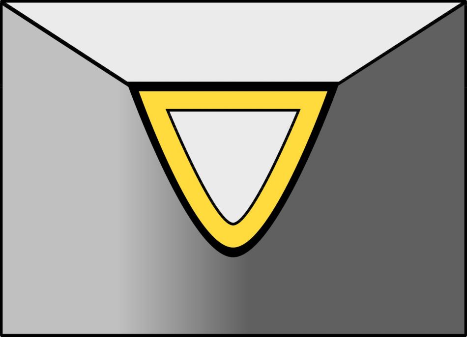

Coated HSS-E-PM. PVD — heat- and wear-resistant high vanadium — cobalt powder metal HSS substrate. Coating consists of low-friction CrC/C over wear-resistant TiN base layer. Use for tapping stainless steel and non-ferrous materials.
  • KM6515 TiN + CrC/C for stainless steel.
  • KP6525 TiCN + TiN for steel.
