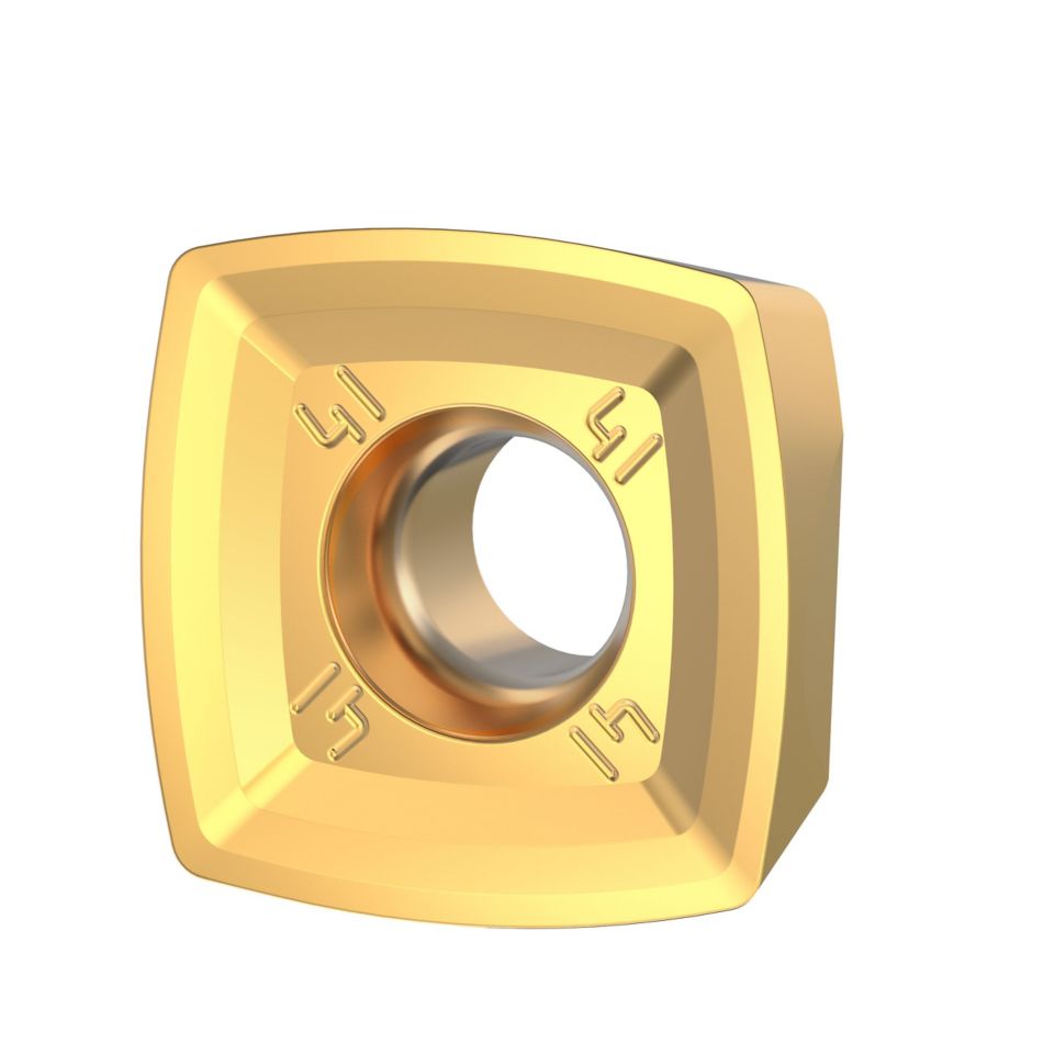

7792VXD12 Series • Carbide Insert • XDPT-D41 • Medium Machining
High-feed copy milling insert with four cutting edges.
Material Number6010772
ISO Catalog IDXDPT120508ERD41ANSI Catalog IDXDPT120508ERD41

GradeX500
[D] Insert IC Size12.7 mm
[D] Insert IC Size0.5 in
[LI] Insert Length 12.7 mm
[LI] Insert Length 0.5 in
[S] Insert Thickness5.556 mm
[S] Insert Thickness0.219 in
[Rε] Corner Radius 0.8 mm
[Rε] Corner Radius 0.031 in
Average Chip Thickness [HM]0.05 mm
Average Chip Thickness [HM]0.002 in
[RT] Theoretical Corner Radius Programing2.5 mm
[RT] Theoretical Corner Radius Programing0.098 in
X500
X500
CVD TiN/TiCN/TiN coated carbide on tough substrate (X-Grade™ technology). For difficult applications with heavy impacts, vibrations, or unstable conditions. High stability against thermal cracks. Excellent grade for high-temperature alloys, stainless steels, and titanium.
  • Pressed-to-size, for lowest cost per cutting edge
  • Single-sided copy milling insert for machining of steels, stainless steel and high-temperature alloys
