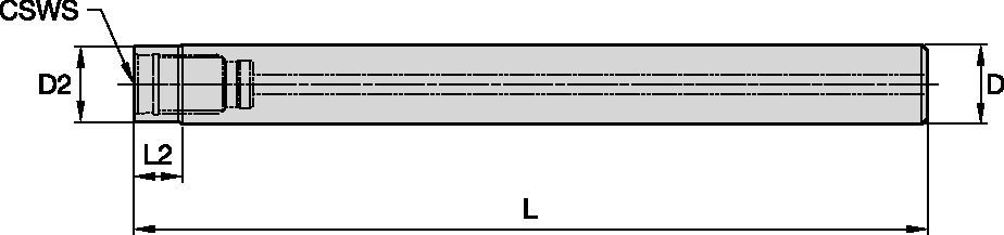

  • Shank: Duo-Lock CouplingShank: Duo-Lock Coupling
  • Balance (G 2.5/25,000)Balance (G 2.5/25,000)
Drawings for 6135044
Material Number6135044
ISO Catalog IDSS12DL12120M
ANSI Catalog IDSS12DL12120M
[CSWS] System Size Workpiece SideDL12
[D] Adapter / Shank / Bore Diameter0.4724 in
[D2] Body Diameter 1 Workpiece Side 11.5 mm
[D2] Body Diameter 1 Workpiece Side 0.453 in
[L] Overall Length 120 mm
[L] Overall Length 4.724 in
[L2] Usable Length 6 mm
[L2] Usable Length 0.236 in
Weight Kilograms0.09
  • Length modification by cutting off the shank.
