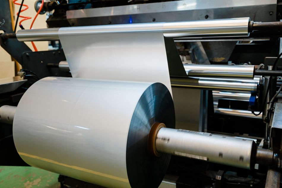

Metallizing, also known as vacuum metallizing, creates a uniform coating on polymer films, paper and other substrates. The process involves preparing the substrate, melting and evaporating the metal. Depending on the application the desired purpose of the coating can be decorative as well as create a barrier or a conductive layer.

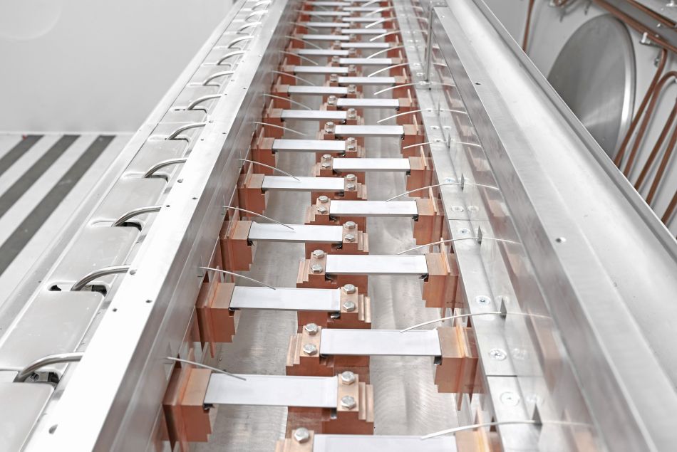

Evaporator Boat Procedure Check List:
- Make sure the alignment and smoothness of your copper clamps are correct.
- Use graphite tape for uniform electrical and thermal conductivity.
- Use pieces of aluminum wire for the initial heat-up to determine the correct starting temperature.
- Adjust the wire feed to the central position on the boat’s surface.
- Follow the heat-up cycle to ensure the reannealing of the boats during the first heat-up (approximately 12-14 minutes).
- Start the wire at 75% of the normal feed rate and reduce power to achieve maximum wetting over the length of the cavity.
- Begin metallizing and gradually increase the wire feed rate over the first 15 minutes of production.
- Upon completion of the coating.
- Stop the wire.
- Stop power 20-30 seconds later.
- Wait approximately 2 minutes before releasing the vacuum to ensure the boats have cooled below red heat.

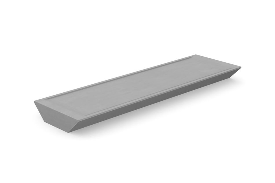

T-VAP Evaporator Boat
- Maximizes surface evaporation and provides a uniform temperature profile
- Consumes less power
- Increases yield of Aluminum to the substrate

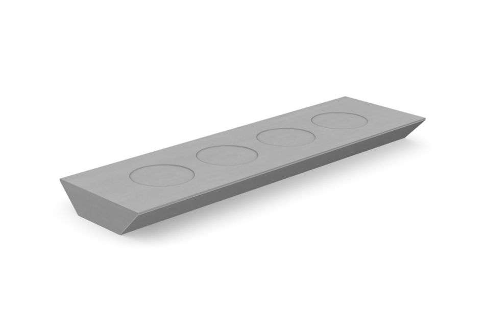

T-VAP MAX Evaporator Boat
- Significantly extends boat life
- Prevents metal overflow and lessens spitting
- Enables peak surface evaporation and temperature uniformity
- Uses less power while increasing aluminum yields

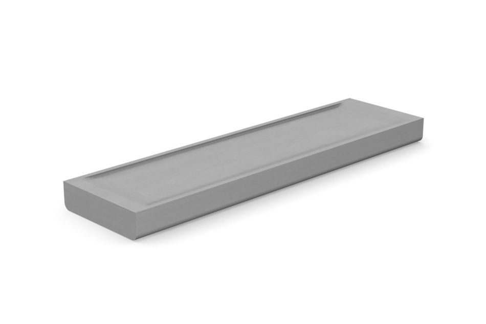

Standard Evaporator Boat
- All-purpose ceramic evaporator boat
- Features a sturdy design for long-term stability
- Deploys in vacuum chambers with side or end clamping
