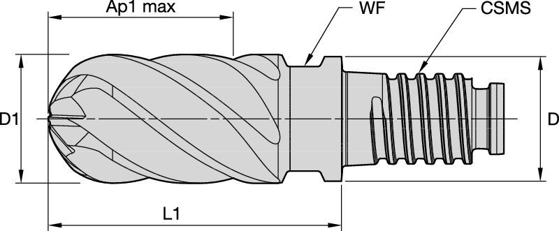

Drawings for 6072389
Material Number6072389
ISO Catalog IDUJBV2000X6CN
ANSI Catalog IDUJBV2000X6CN
GradeKCSM15
Adapter Style Machine SideDUO-LOCK
[D1] Effective Cutting Diameter20 mm
[D1] Effective Cutting Diameter0.7874 in
[D] Adapter / Shank / Bore Diameter19.3 mm
[D] Adapter / Shank / Bore Diameter0.7598 in
[AP1MAX] 1st Maximum Cutting Depth30 mm
[AP1MAX] 1st Maximum Cutting Depth1.1811 in
[L1] Gage Length45 mm
[L1] Gage Length1.7717 in
[CSMS] System Size Machine SideDL20
[WF] Width of Flat 16 mm
[WF] Width of Flat 0.6299 in
[Z] Number of Flutes6

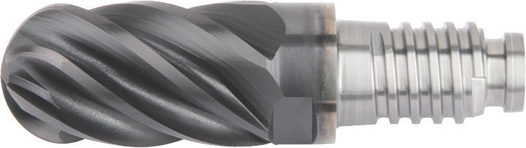

KCSM15
KCSM15
Coated carbide grade with thick PVD coating and optimized chemistry
and process for increased wear resistance. Outstanding protection in milling stainless steel to mitigate crater, DOCN (depth-of-cut notching), and flank wear. Excellent performance up to 52 HRC.
  • Modular end mill for high performance profiling in high temperature alloys.
  • Roughing and finishing with one tool.
  • Centre cutting.
  • Asymmetrical flute spacing and variable helix configuration minimizes chatter and harmonics for smoother machining.
