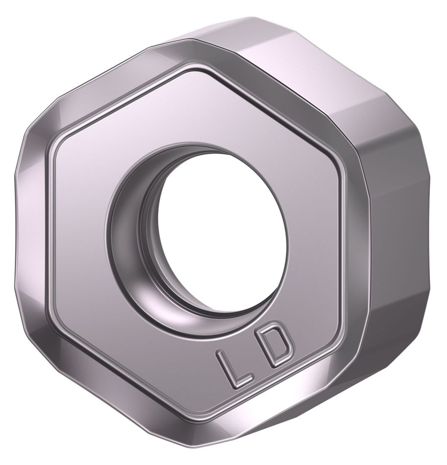

Face milling insert with twelve cutting edges, precision ground
Material Number4121576
ISO Catalog IDHNGJ0604ANENLDANSI Catalog IDHNGJ43ANENLD
Dodeka Mini Carbide Insert - HNGJ-LD - Light Machining - Grade KC510M - 4121576 - Kennametal.com
$34.98/each
Drawings for 4121576
GradeKC510M
[D] Insert IC Size12 mm
[D] Insert IC Size0.472 in
[BS] Corner Facet Length 1.515 mm
[BS] Corner Facet Length 0.0596 in
[L10] Insert Cutting Edge Length6.928 mm
[L10] Insert Cutting Edge Length0.2728 in
[Rε] Corner Radius 1 mm
[Rε] Corner Radius 0.039 in
[S] Insert Thickness4.479 mm
[S] Insert Thickness0.1763 in
Average Chip Thickness [HM]0.04 mm
Average Chip Thickness [HM]0.0016 in
Cutting Edges per Insert12
KC510M
KC510M
Coated carbide grade with a TiAiN coating (PVD). KC510M is a highly wear-resistant grade primarily for use in milling aluminum and high-temperature alloys in light applications. Can also be used for machining of steel and hardened steel.
