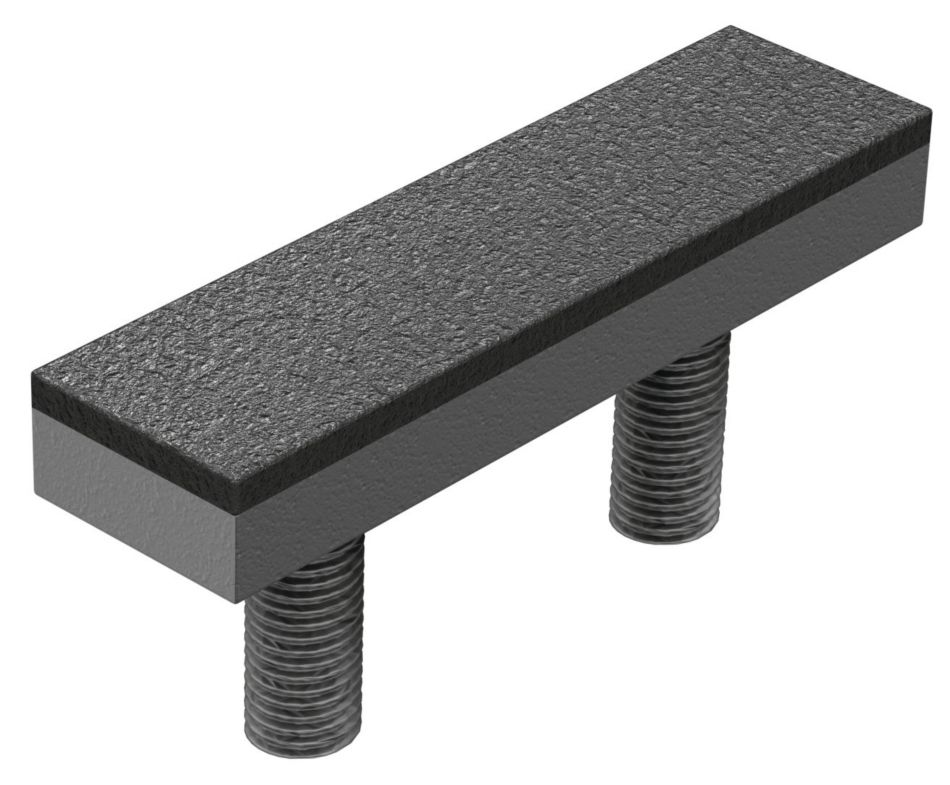

KenCast Tungsten Carbide & Steel Wear Protection • Bolt-On Wear Protection
KenCast Bolt-On Wear Protection for Kicker Paddles and other applications where bolting on from behind is possible

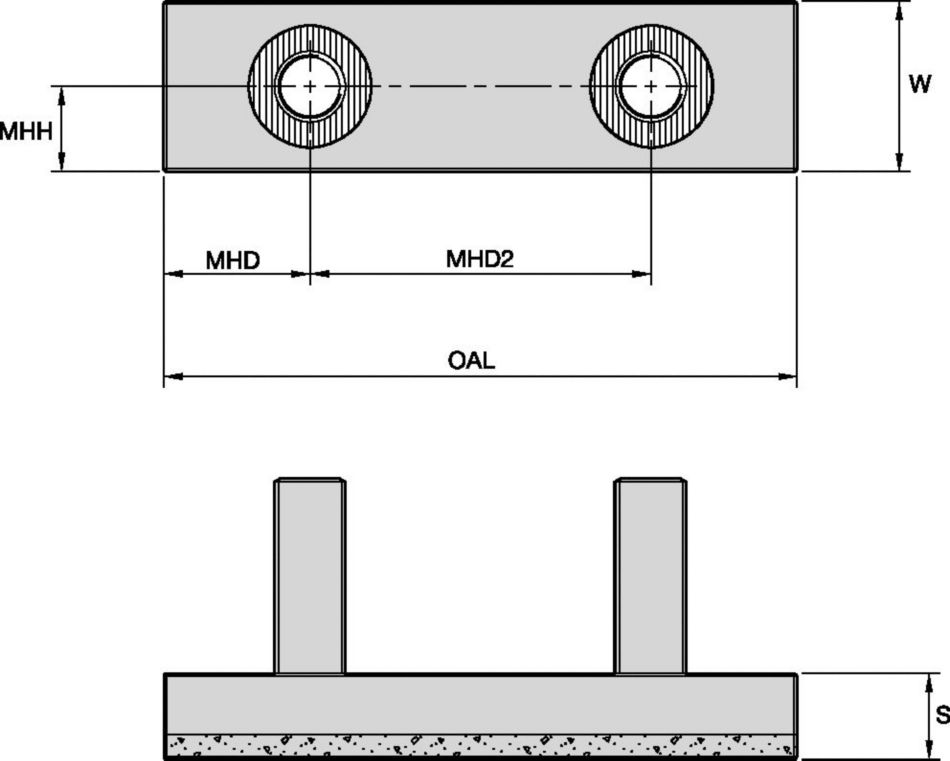

Drawings for 1542508
Material Number1542508
ISO Catalog IDKCWB-0406
ANSI Catalog IDKCWB-0406
[MHD] Mount Hole Distance38.1 mm
[MHD] Mount Hole Distance1.5 in
[MHD2] Mount Hole 2 Distance88.9 mm
[MHD2] Mount Hole 2 Distance3.5 in
[MHH] Mount Hole Height22.23 mm
[MHH] Mount Hole Height0.88 in
[OAL] Overall Length165.1 mm
[OAL] Overall Length6.5 in
[OAW] Overall Width44.45 mm
[OAW] Overall Width1.75 in
[S] Thickness22.35 mm
[S] Thickness0.88 in

  • Extreme versatility — complex parts and geometries can be produced and customized to specific wear issues.
  • Excellent wear resistance — lowering repair costs and downtime.
  • Additional protection for your equipment.
  • Typical applications include bucket lips, drill stabilizers, grouser bars, shovel protection, dozer blade wear areas.
  • Easy to apply in the field.
  • Non-layered material.
