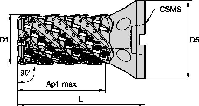

HARVI™ Ultra 8X • Helical Mill • SNHJ10 • Taper Flange Mount • For Corner Radius .031"-.125" (0,8-3,2mm) • Inch
Shoulder milling cutter with maximum tool stiffness for steel, stainless steel, and high-temperature alloys.
Material Number104202320
- Designed for aerospace airframe structural component machining, targeting maximum metal removal rates (MRR).
- Taper flange provides higher stability than straight flanges, adding unequaled benind moment resistance.
- Internal coolant supply.
- Adjustable coolant nozzles support chip evacuation and control heat in the cutting zone.
- Large helix ensures hassle-free chip evacuation event at highest metal removal rates (MRR).
Slotting: Shoulder Profiling
Slotting: Shoulder
Shank: Flange Mount Milling
Side Milling/Shoulder Milling: Eased Chamfer
Milling - Through Coolant
Pocketing
