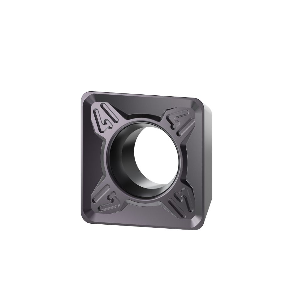

5230VS12 Series • Carbide Insert • SDMT12-EN41 • Light Machining of Steels and High-Temperature Alloys
Shoulder milling insert with four cutting edges.
Material Number5665740
ISO Catalog IDSDMT120412EN41ANSI Catalog IDSDMT120412EN41
5230VS12 IN SDMT12-EN41 Milling - 5665740 - Kennametal
$23.63/each
Drawings for 5665740
GradeSP6519
[D] Insert IC Size12.7 mm
[D] Insert IC Size0.5 in
[S] Insert Thickness4.76 mm
[S] Insert Thickness0.1874 in
[Rε] Corner Radius 1.2 mm
[Rε] Corner Radius 0.047 in
Average Chip Thickness [HM]0.05 mm
Average Chip Thickness [HM]0.002 in
Cutting Edges per Insert4
SP6519
SP6519
Coated carbide grade with PVD TiAlN nano-composite coating on a tough substrate. Primarily for use in general and heavy machining, dry and wet.
