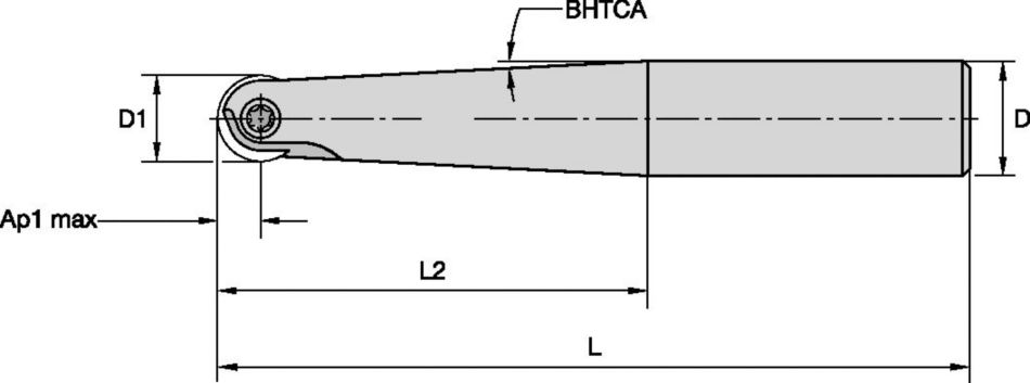

Drawings for 3964260
Material Number3964260
ISO Catalog IDKDMB10R100A12HNC
ANSI Catalog IDKDMB10R100A12HNC
[D1] Effective Cutting Diameter10 mm
[D1] Effective Cutting Diameter0.3937 in
[D] Adapter / Shank / Bore Diameter0.4724 in
Half Taper Clearance Angle [BHTCA]1.25
[L2] Head Length 60 mm
[L2] Head Length 2.3622 in
[L] Overall Length 100 mm
[L] Overall Length 3.937 in
[L1] Gage Length100 mm
[L1] Gage Length3.937 in
[L3] Usable Length5 mm
[L3] Usable Length0.1969 in
[AP1MAX] 1st Maximum Cutting Depth5 mm
[AP1MAX] 1st Maximum Cutting Depth0.1969 in
Number of Inserts1
[Z] Number of Flutes2
Coolant SupplyY
Maximum Ramping Angle3
Max RPM40000
Gage InsertKDMB10.
