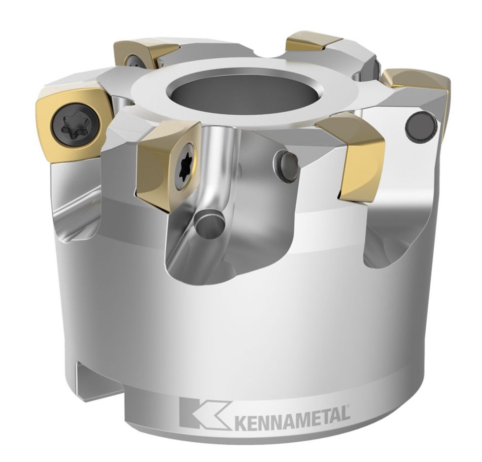

7792VXD09 Series • Shell Mill • Metric
High-Feed copy milling cutter for multiple materials.

| Material Number | 5657234 |
| ISO Catalog ID | 7792VXD09-A040Z4R |
| ANSI Catalog ID | 7792VXD09-A040Z4R |
| [D1MAX] Maximum Cutting Diameter | 40 mm |
| [D1MAX] Maximum Cutting Diameter | 1.575 in |
| [D1] Effective Cutting Diameter | 26.75 mm |
| [D1] Effective Cutting Diameter | 1.053 in |
| [D] Adapter / Shank / Bore Diameter | 16 mm |
| [D] Adapter / Shank / Bore Diameter | 0.63 in |
| [D6] Hub Diameter | 36.31 mm |
| [D6] Hub Diameter | 1.43 in |
| [L] Overall Length | 32 mm |
| [L] Overall Length | 1.26 in |
| [AP1MAX] 1st Maximum Cutting Depth | 1.5 mm |
| [AP1MAX] 1st Maximum Cutting Depth | 0.059 in |
| [Z] Number of Flutes | 4 |

- Internal coolant supply
- Positive design to support low cutting forces and applications with long overhang
