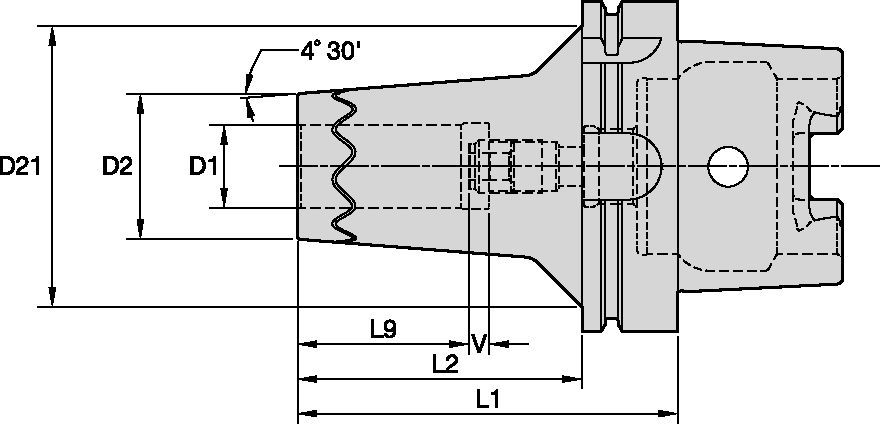

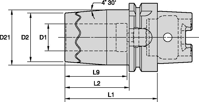

Drawings for 5090058
Material Number5090058
ISO Catalog IDHSK100ASFTT16100M
ANSI Catalog IDHSK100ASFTT16100M
[D1] Adapter / Shank / Bore Diameter16 mm
[D1] Adapter / Shank / Bore Diameter0.6299 in
[D2] Body Diameter 1 Workpiece Side 33 mm
[D2] Body Diameter 1 Workpiece Side 1.2992 in
[D21] Body Diameter 2 Workpiece Side78 mm
[D21] Body Diameter 2 Workpiece Side3.0709 in
[L1] Gage Length100 mm
[L1] Gage Length3.937 in
[L2] Usable Length 71 mm
[L2] Usable Length 2.7953 in
[L9] Clamping Length 40 mm
[L9] Clamping Hole Length 1.5748 in
[V] Adjustment Range 10 mm
[V] Adjustment Range 0.3937 in
Weight Kilograms2.6
