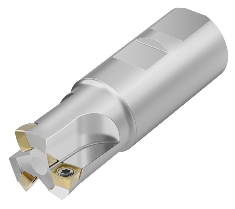

7792VXD09 Series • End Mill • Weldon Shank • Metric
High-Feed copy milling cutter for multiple materials.
Material Number5658074
ISO Catalog ID7792VXD09WA032Z3RANSI Catalog ID7792VXD09WA032Z3R

| Material Number | 5658074 |
| ISO Catalog ID | 7792VXD09WA032Z3R |
| ANSI Catalog ID | 7792VXD09WA032Z3R |
| [D1MAX] Maximum Cutting Diameter | 32 mm |
| [D1MAX] Maximum Cutting Diameter | 1.26 in |
| [D] Adapter / Shank / Bore Diameter | 32 mm |
| [D] Adapter / Shank / Bore Diameter | 1.26 in |
| [D1] Effective Cutting Diameter | 18.75 mm |
| [D1] Effective Cutting Diameter | 0.738 in |
| [L] Overall Length | 100 mm |
| [L] Overall Length | 3.937 in |
| [L2] Head Length | 39.8 mm |
| [L2] Head Length | 1.5669 in |
| [AP1MAX] 1st Maximum Cutting Depth | 1.5 mm |
| [AP1MAX] 1st Maximum Cutting Depth | 0.059 in |
| [Z] Number of Flutes | 3 |

- Internal coolant supply
- Positive design to support low cutting forces and applications with long overhang
