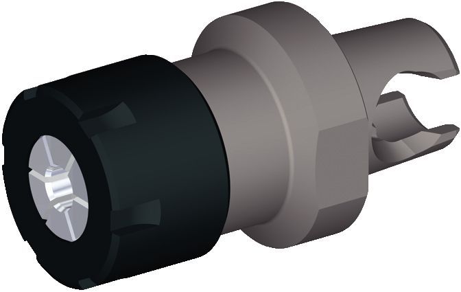

ER Single-Angle Collet Chucks
Material Number2527515
ISO Catalog IDKM3225ER2545ANSI Catalog IDKM3225ER2545
ER-KM3225 Tooling Systems - 2527515 - WIDIA
$353.40/each
  • KM Mini ShankKM Mini Shank
Drawings for 2527515
[CST] Catalog Collet SeriesER25
[CSMS] System Size Machine SideKM3225
[D11] Lock Nut Diameter42 mm
[D11] Lock Nut Diameter1.6535 in
[L1] Gage Length45 mm
[L1] Gage Length1.7717 in
[L9] Clamping Length 38.8 mm
[L9] Clamping Hole Length 1.528 in
Counter Bore Collet Torque Nm104
Straight Collet Torque Nm104
Weight Kilograms0.25
Weight Pounds0.55
