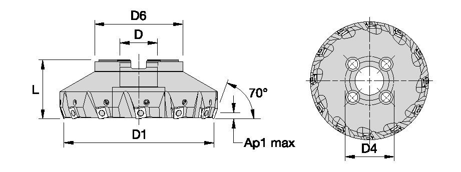

| Material Number | 1503057 |
| ISO Catalog ID | 200C16RP70SP12C4WFP |
| ANSI Catalog ID | 200C16RP70SP12C4WFP |
| [D1] Effective Cutting Diameter | 200 mm |
| [D1] Effective Cutting Diameter | 7.874 in |
| [D] Adapter / Shank / Bore Diameter | 60 mm |
| [D] Adapter / Shank / Bore Diameter | 2.3622 in |
| [D2] Maximum Body Diameter | 212.4 mm |
| [D2] Maximum Body Diameter | 8.3622 in |
| [D4] Bolt Circle 4 | 101.6 mm |
| [D4] Bolt Circle 3 | 4 in |
| [D6] Hub Diameter | 134 mm |
| [D6] Hub Diameter | 5.469 in |
| [L] Overall Length | 63 mm |
| [L] Overall Length | 2.4803 in |
| [AP1MAX] 1st Maximum Cutting Depth | 5.9 mm |
| [AP1MAX] 1st Maximum Cutting Depth | 0.232 in |
| Number of Inserts | 16 |
| Number of Adjustable Inserts | 4 |
| Weight Kilograms | 6.5 |
| Max RPM | 1600 |
