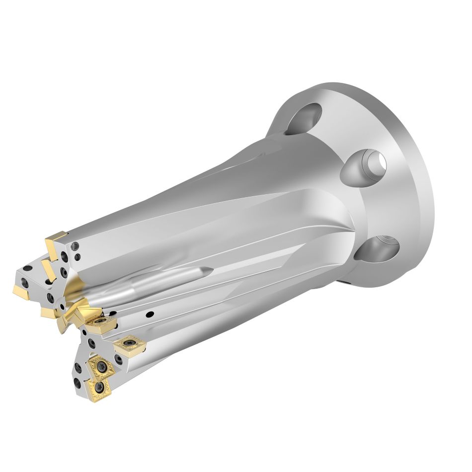

Número de material6670013
Referencia ISOKSEMX9000FBX150BTF46MReferencia ANSIKSEMX9000FBX150BTF46M
Diámetro de broca M [D1] 90 mm
Diámetro de broca M [D1] 3.549 in
Broca piloto Diámetro de corte [PDD]25 mm
Broca piloto Diámetro de corte [PDD]0.984 in
Longitud de protrusión piloto [PPL] 0.2 mm
Longitud de protrusión piloto [PPL] 0.008 in
Longitud de calibre de plaquita [L1] 215 mm
Longitud de calibre de plaquita [L1] 8.462 in
Profundidad máxima de taladrado [L4] 150 mm
Profundidad máxima de taladrado [L4] 5.9055 in
Diámetro de cuerpo máximo [D5] 117.475 mm
Diámetro de cuerpo máximo [D5] 4.625 in
Tamaño de asiento de la plaquita [SSC]5

  • Advanced drill body design for flat bottom drilling and plunging
  • Two effective cutting edges in the center for maximum feed
  • Four effective cutting edges on the outer diameter for highest productivity on plunging operations
  • Interchangeable coolant nozzles in different sizes for optimized heat control
  • Four flutes for reliable chip evacuation and highest tool stiffness
  • BTF taper flange connection for maximum stability and flexibility
  • Use the pocket seat size SSC to select a suitable center insert
