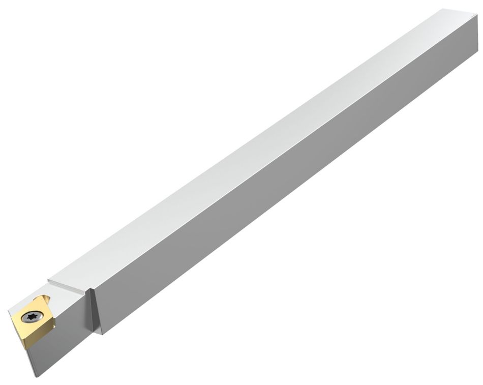

Material Number1132990
ISO Catalog IDDCMT070204LF
ANSI Catalog IDDCMT2151LF
GradeK313
[D] Insert IC Size6.35 mm
[D] Insert IC Size.25 in
[L10] Insert Cutting Edge Length7.752 mm
[L10] Insert Cutting Edge Length.3052 in
[S] Insert Thickness2.38 mm
[S] Insert Thickness.0938 in
[Rε] Corner Radius 0.4 mm
[Rε] Corner Radius .0156 in
[D1] Insert Hole Size 2.9 mm
[D1] Insert Hole Size .1142 in
  • CFRP Materials
K313
K313
Composition: A hard, low binder content, unalloyed WC/Co fine-grain grade.
Application: Exceptional edge wear resistance combined with very high strength for machining titanium, cast irons, austenitic stainless steels, non-ferrous metals, non-metals, and most high-temp alloys. Superior thermal deformation and depth-of-cut notch resistance. The grain structure is well controlled for minimal pits and flaws, which contributes to long, reliable service.
  • Finishing geometry with light cutting action
  • Used in multiple material groups
