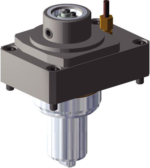

Driven Tool Axial • KM™ • TACU020KM40DA60945555, TACU020KM40DA60945556
Mazak™ • Driven Tool Axial • KM™ • MMC 020
Material Number6391660
ISO Catalog IDTACU020KM40DA60945556ANSI Catalog IDTACU020KM40DA60945556
Turret Adapter Clamping Units • Mori Seiki

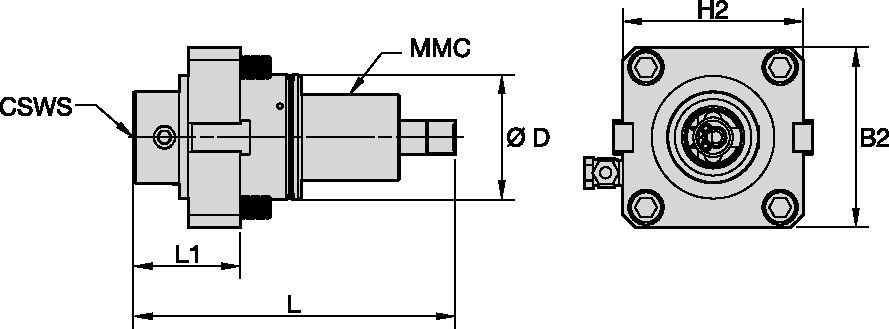

[CSWS] System Size Workpiece SideKM40
Machine Mount Code020
[B1] Front Clearance 54 mm
[B1] Front Clearance 2.126 in
[B2] Overall Width 128 mm
[B2] Overall Width 5.039 in
[D] Adapter / Shank / Bore Diameter68 mm
[D] Adapter / Shank / Bore Diameter2.677 in
[H2] Overall Height 86 mm
[H2] Overall Height 3.386 in
[L] Overall Length 162 mm
[L] Overall Length 6.378 in
[L1] Gage Length72 mm
[L1] Gage Length2.835 in
Torque Machine Spindle Nm50
Coolant Pressure Bar25
Coolant Pressure PSI360
Coolant DeliveryI/E
[CS1] Coolant Supply Exit SizeG 1/8
Max RPM6000
Weight Kilograms5.64
Torque Catalog Newton Meters12-16
Torque Catalog Foot Pounds9-12
