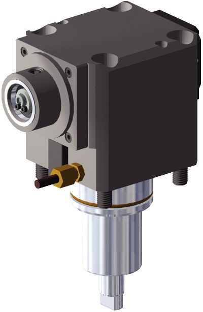

Driven Tool Radial • KM™ • TACU035KM32DR60945563, TACU035KM32DR60945564
Hyundai WIA • Driven Tool Radial • KM™ • MMC 035
Material Number6391656
ISO Catalog IDTACU035KM32DR60945564ANSI Catalog IDTACU035KM32DR60945564
6391656 - Kennametal
$5,673.55/each
Drawings for 6391656
[CSWS] System Size Workpiece SideKM32
Machine Mount Code035
[B2] Overall Width 148.5 mm
[B2] Overall Width 5.846 in
[D] Adapter / Shank / Bore Diameter55 mm
[D] Adapter / Shank / Bore Diameter2.165 in
[F] F Dimension 78 mm
[F] F Dimension 3.071 in
[H2] Overall Height 85 mm
[H2] Overall Height 3.35 in
[L] Overall Length 194 mm
[L] Overall Length 7.637 in
[L1] Gage Length60 mm
[L1] Gage Length2.362 in
[LPR] Protruding Length 90 mm
[LPR] Protruding Length 3.543 in
Torque Machine Spindle Nm25
Coolant Pressure Bar70
Coolant Pressure PSI1000
Coolant DeliveryI/E
[CS1] Coolant Supply Exit SizeG 1/8
Max RPM6000
Weight Kilograms6.94
Torque Catalog Newton Meters8-11
Torque Catalog Foot Pounds6-8
