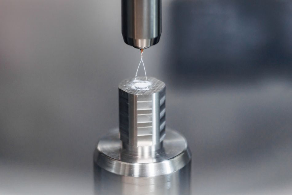

Micromachining involves the engineering of extremely small, intricate and precise components. It uses advanced CNC machinery and techniques to turn, drill, mill or thread workpieces measured by microns.

Drilling: A cornerstone of micromachining, drilling is indispensable for the production of surgical implements and medical devices. It allows for the creation of minuscule holes mechanical parts in surgical tools to hold pins, rods and other tools during procedures. Some orthopedic implants, such as bone plates, also require precision drilling.

KenDrill™ Micro: The first Kennametal microdrill for short and deep-hole applications featuring a versatile design that's capable of machining multiple materials, including medical grade stainless steel, titanium and cobalt chrome alloys

Microdrilling enables the construction of intricate microfluidic channels and chambers on a chip to help manipulate fluids at the micro-scale for controlled chemical analysis, drug testing, and medical diagnostics.
