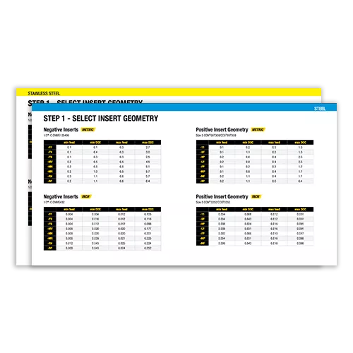

Application Data is Now Available!
Download Now
