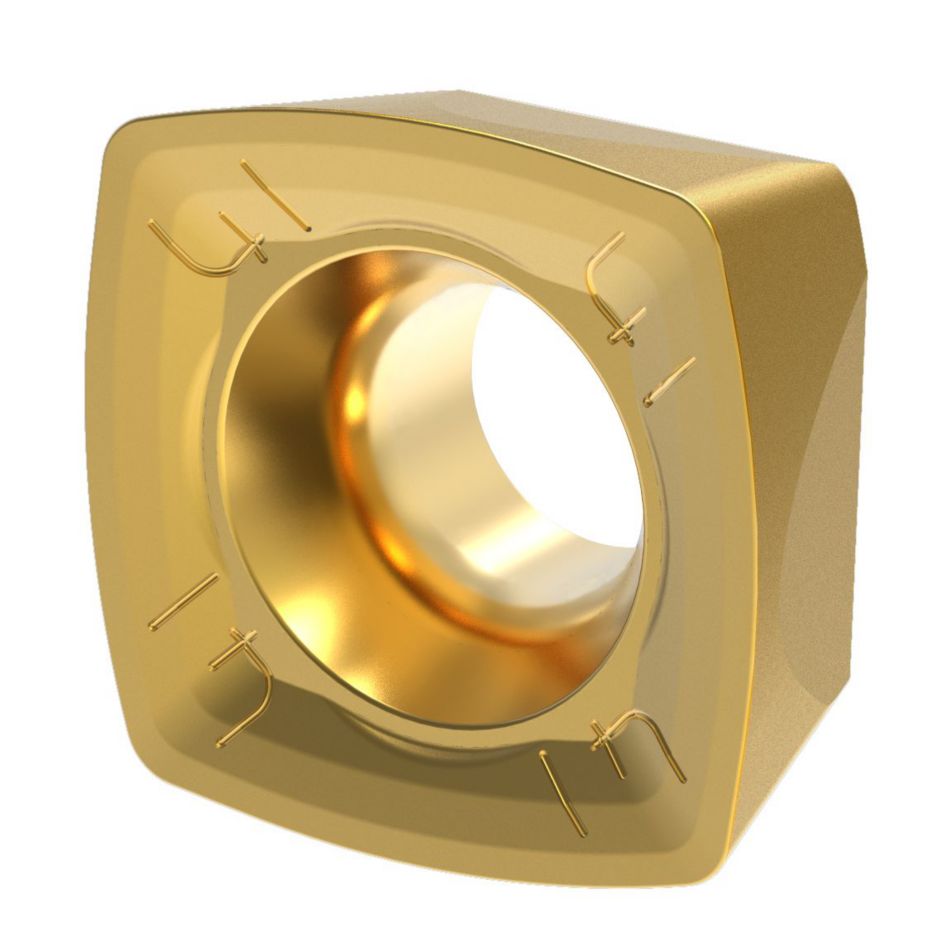

XDLT09-D41 • General purpose in soft steels. Best fit for face milling, slotting operation
Milling Inserts
Material Number100035925
- Precision pressed.
- First choice for machining stainless steel and high-temp alloys.
