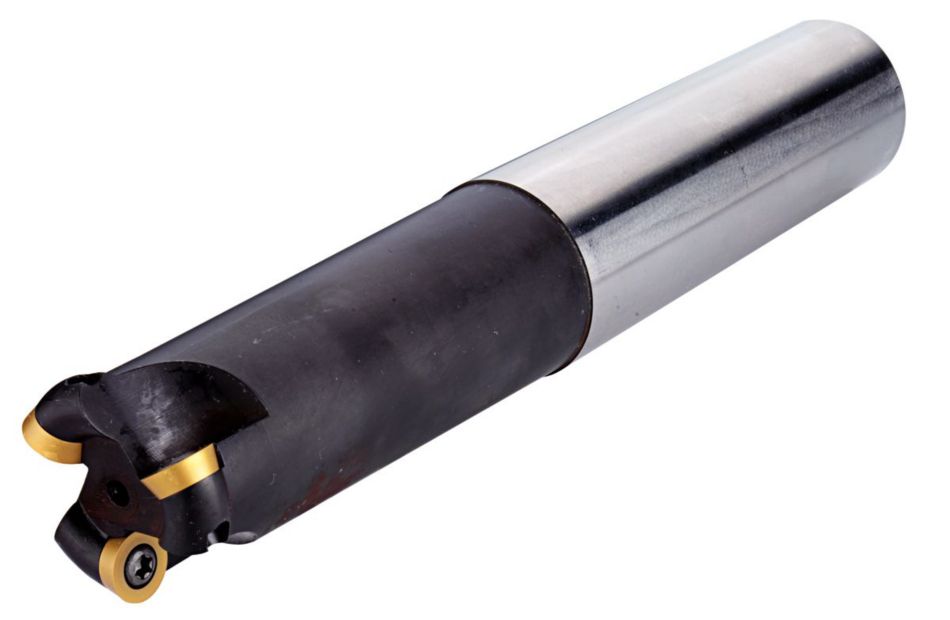

KDM • Weldon® Shank End Mills • RD.X10... • Metric
Material Number1888460
ISO Catalog ID20E02R120B25SRD10ANSI Catalog ID20E02R120B25SRD10
- P Steel
- M Stainless Steel
- K Cast Iron
- N Non-Ferrous
- S High-Temp Alloys
- H Hardened Materials
- .caption
Helical Milling
Ramping: Blank
Side Milling/Shoulder Milling: Ball Nose
3D Profiling
Shank - Cylindrical Weldon
Pocketing
- Overview
- Application Data
- Downloads
- Spare Parts
| Material Number | 1888460 |
| ISO Catalog ID | 20E02R120B25SRD10 |
| ANSI Catalog ID | 20E02R120B25SRD10 |
| [D1MAX] Maximum Cutting Diameter | 20 mm |
| [D1MAX] Maximum Cutting Diameter | 0.7874 in |
| [D1] Effective Cutting Diameter | 10 mm |
| [D1] Effective Cutting Diameter | 0.3937 in |
| [D] Adapter / Shank / Bore Diameter | 25 mm |
| [D] Adapter / Shank / Bore Diameter | 0.9843 in |
| [L] Overall Length | 180 mm |
| [L] Overall Length | 7.0866 in |
| [L1] Gage Length | 180 mm |
| [L1] Gage Length | 7.0866 in |
| [L3] Usable Length | 60 mm |
| [L3] Usable Length | 2.3622 in |
| [AP1MAX] 1st Maximum Cutting Depth | 5 mm |
| [AP1MAX] 1st Maximum Cutting Depth | 0.1969 in |
| Number of Inserts | 2 |
| Maximum Ramping Angle | 15 |
| Weight Kilograms | 0.52 |
| Gage Insert | RD_X1003__ |
