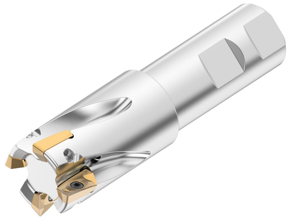

Mill 1-14™ • End Mill • Reduced Diameter Weldon Shank • For Corner Radii Greater than .079" (2mm) • Inch
Material Number2624271
ISO Catalog IDM1D150E1405W125L225RANSI Catalog IDM1D150E1405W125L225R
- P Steel
- M Stainless Steel
- K Cast Iron
- N Non-Ferrous
- S High-Temp Alloys
- H Hardened Materials
- .caption
Face Milling
Helical Milling
Ramping: Blank
Slotting: Square End
Milling - Through Coolant
Shank - Cylindrical Weldon 2 Flat
Pocketing
- Overview
- Application Data
- Downloads
- Spare Parts
| Material Number | 2624271 |
| ISO Catalog ID | M1D150E1405W125L225R |
| ANSI Catalog ID | M1D150E1405W125L225R |
| [D1] Effective Cutting Diameter | 38.1 mm |
| [D1] Effective Cutting Diameter | 1.5 in |
| [D] Adapter / Shank / Bore Diameter | 31.75 mm |
| [D] Adapter / Shank / Bore Diameter | 1.25 in |
| [L] Overall Length | 114.56 mm |
| [L] Overall Length | 4.51 in |
| [L2] Head Length | 56.65 mm |
| [L2] Head Length | 2.23 in |
| [AP1MAX] 1st Maximum Cutting Depth | 14.1 mm |
| [AP1MAX] 1st Maximum Cutting Depth | 0.555 in |
| Number of Inserts | 5 |
| Maximum Ramping Angle | 5.5 |
| Weight Pounds | 1.53 |
| Max RPM | 29600 |
- Steel
- Stainless Steel
- Cast Iron
- Non-Ferrous
- High-Temp Alloys
- Hardened Materials
- .caption
Face Milling
Helical Milling
Ramping: Blank
Pocketing
- Internal coolant supply
- For ramping, slotting, plunging, facing and true 90° walls
- These end mills accept inserts with corner radii greater than .079" (2mm) without further pocket modifications

| Mill 1-14 | 1.250 | 7˚ | 1.873 | 2.50 | 2.322 |
| Mill 1-14 | 1.500 | 5˚ | 2.370 | 3.00 | 2.822 |
| Mill 1-14 | 2.000 | 4˚ | 3.368 | 4.00 | 3.822 |
| Mill 1-14 | 2.500 | 3˚ | 4.367 | 5.00 | 4.822 |
| Mill 1-14 | 3.000 | 2˚ | 5.366 | 6.00 | 5.822 |
| Mill 1-14 | 4.000 | 2˚ | 7.366 | 8.00 | 7.822 |
Insert Selection Guide
| Material | Light | Medium | Heavy | |||
| P1–P2 | .E..GD | KCPM40 | .S..GD2 | KCPM40 | .E..HD2 | KCPM40 |
| P3–P4 | .E..GD | KCPM40 | .S..GD2 | KCPK30 | .E..HD2 | KCPK30 |
| P5–P6 | .E..GD | KC725M | .S..GD2 | KC725M | .E..HD2 | KC725M |
| M1–M2 | .E..LD | KC522M | .E..GD | KCSM40 | .E..HD2 | KC522M |
| M3 | .E..GD | KCSM40 | .S..GD2 | KCPM40 | .E..HD2 | KCPM40 |
| K1–K2 | .S..GD2 | KCK20B | .E..HD2 | KCK20B | .E..HD2 | KCK15 |
| K3 | .S..GD2 | KCK20B | .E..HD2 | KCK20B | .E..HD2 | KCK15 |
| N1–N2 | .F..LDJ | KC410M | .F..LDJ | KC410M | .E..LDJ | KC422M |
| N3 | .F..LDJ | KC410M | .F..LDJ | KC410M | .E..LDJ | KC422M |
| S1–S2 | .E..GD | KC725M | .S..GD2 | KC725M | .E..HD2 | KC725M |
| S3 | .E..GD | KCSM40 | .S..GD2 | KC725M | .E..HD2 | KC725M |
| S4 | .E..GD | KCSM40 | .S..GD2 | KC725M | .E..HD2 | KC522M |
