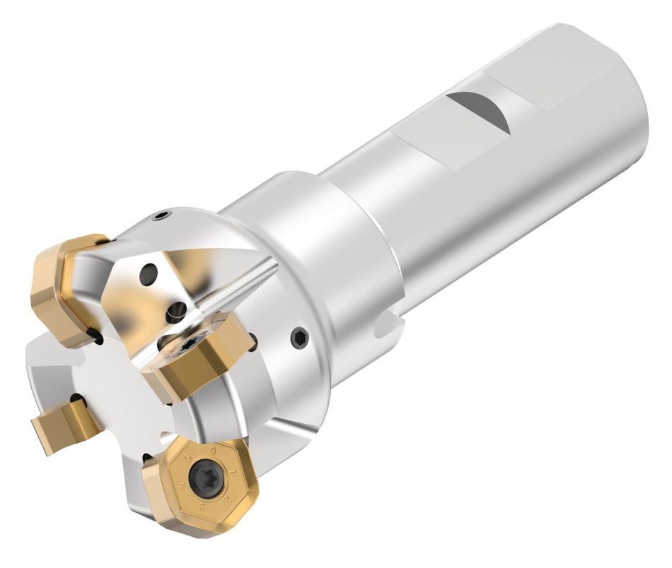

Dodeka™ 45° • End Mill • Weldon® Shank • Metric
Face milling cutter for multiple materials
Material Number3324829
ISO Catalog IDKSHR40D03R50B25SHN09ANSI Catalog IDKSHR40D03R50B25SHN09
- P Steel
- M Stainless Steel
- K Cast Iron
- N Non-Ferrous
- S High-Temp Alloys
- H Hardened Materials
- .caption
Face Milling
Side Milling/Shoulder Milling: Eased Chamfer
Shank - Cylindrical Weldon
Milling - Through Coolant
- Overview
- Application Data
- Downloads
- Spare Parts
| Material Number | 3324829 |
| ISO Catalog ID | KSHR40D03R50B25SHN09 |
| ANSI Catalog ID | KSHR40D03R50B25SHN09 |
| [D1] Effective Cutting Diameter | 40 mm |
| [D1] Effective Cutting Diameter | 1.5748 in |
| [D1MAX] Maximum Cutting Diameter | 51.01 mm |
| [D1MAX] Maximum Cutting Diameter | 2.008 in |
| [D] Adapter / Shank / Bore Diameter | 25 mm |
| [D] Adapter / Shank / Bore Diameter | 0.9843 in |
| [L] Overall Length | 107 mm |
| [L] Overall Length | 4.213 in |
| [L3] Usable Length | 50 mm |
| [L3] Usable Length | 1.969 in |
| [AP1MAX] 1st Maximum Cutting Depth | 4.5 mm |
| [AP1MAX] 1st Maximum Cutting Depth | 0.177 in |
| Number of Inserts | 3 |
| Weight Kilograms | 0.53 |
| Max RPM | 15800 |
