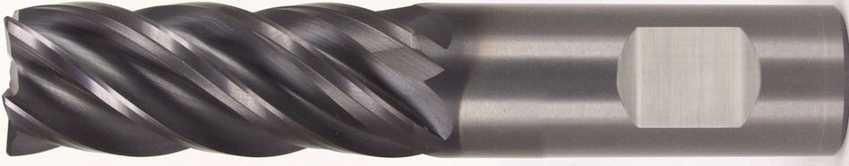

HARVI™ II • Square End • 5 Flutes • Plain Shank • Inch
HARVI™ II Solid Carbide End Mill for Roughing and Finishing of Multiple Materials
Material Number3580836
ISO Catalog IDUCDE188J5BSANSI Catalog IDUCDE188J5BS

GradeKC643M
[D1] Effective Cutting Diameter4.763 mm
[D1] Effective Cutting Diameter0.1875 in
[D] Adapter / Shank / Bore Diameter4.763 mm
[D] Adapter / Shank / Bore Diameter0.1875 in
[AP1MAX] 1st Maximum Cutting Depth15.875 mm
[AP1MAX] 1st Maximum Cutting Depth0.625 in
[L3] Usable Length15.875 mm
[L3] Usable Length0.625 in
[L] Overall Length 57.15 mm
[L] Overall Length 2.25 in
[Z] Number of Flutes5
  • Ramping: 3°Ramping: 3°
  • Tool Dimensions: Flute Configuration: 5Tool Dimensions: Flute Configuration: 5
KC643M
KC643M
Coated fine-grain grade with PVD multilayer (AlTiN). KC643M™ is a very thin and hard PVD coating particularly suited for cutting steel, cast iron, stainless steel (wet), and titanium (wet). This grade can be used for materials with hardness up to 52 HRC.
  • Versatile solid carbide end mill for steels, stainless steel, cast iron and hard materials
  • HARVI™ II solid carbide end mills cover a variety of operations, including dynamic milling
  • HARVI™ II solid carbide end mills feature unequal flute spacing for chatter-free machining at highest feed rates
  • Slotting up to 1xD
