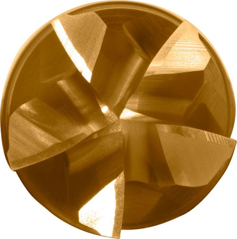

- HARVI™ II TE • Square End • 5 Flutes • Plain Shank • Inch
HARVI™ II TE Five Flute End Mill for Increased MRR Covering the Broadest Range of Applications and Materials;
Roughing and Finishing with One Tool
- Versatile solid carbide endmill for steels, stainless steel, high temperature alloys, and cast iron.
- Chip gashes in the flutes ensure optimum chip removal.
- Eccentric relief provides edge stability in a broad range of materials.
- Proprietary core and flute designs with optimum flute spacing for perfect chip formation and highest tool rigidity.
- Unequally spaced flutes and differential helix allow for the broadest range of applications.
- Unique End Face Design for agressive ramping and plunging operations.
