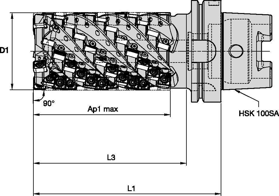

HARVI™ Ultra 8X • Helical Mill • SNHJ12 • Monobloc HSK100A • For Corner Radius .031"-.158" (0,8-4,0mm) • Inch
Shoulder milling cutter for steel, stainless steel, and high-temperature alloys.
Material Number104202329
- ATTENTION: Inserts with corner radius .158"" (4,0mm) require insert pocket modifications.
- Designed for aerospace airframe structural component machining, targeting maximum metal removal rates (MRR).
- Adjustable coolant nozzles support chip evacuation and control heat in the cutting zone.
- Large helix ensures hassle-free chip evacuation event at highest metal removal rates (MRR).
