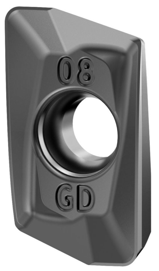

Mill 1-10™ • Carbide Insert • EDPT-GD • Medium Machining
Shoulder milling insert with two cutting edges per insert
Material Number5545216
ISO Catalog IDEDPT10T308PDSRGDANSI Catalog IDEP1008SGD
GradeKCPM40
[LI] Insert Length 12.05 mm
[LI] Insert Length 0.474 in
[S] Insert Thickness3.75 mm
[S] Insert Thickness0.148 in
[W] Insert Width 6.74 mm
[W] Insert Width 0.265 in
[BS] Corner Facet Length 1.7 mm
[BS] Corner Facet Length 0.067 in
[Rε] Corner Radius 0.8 mm
[Rε] Corner Radius 0.031 in
Average Chip Thickness [HM]0.127 mm
Average Chip Thickness [HM]0.005 in
Cutting Edges per Insert2
KCPM40
KCPM40
Coated carbide grade with an advanced PVD TiAlN/AlCrN coating. Tough substrate with excellent capability at higher temperatures. KCPM40™ is the first choice for milling steel and stainless steel. Good thermal shock resistance makes this grade ideal for both wet and dry machining. Primarily for use in general and heavy machining.
  • Pressed-to-size, for lowest cost per cutting edge.
