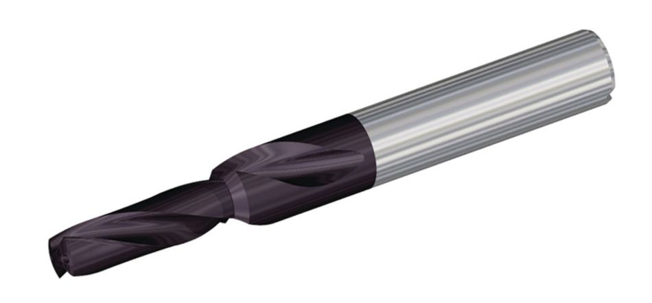

KenDrill™ HP • Long • Internal Coolant • Straight Shank • Metric
Solid Carbide Step Drill for Steel and Cast Iron
Material Number4175409
ISO Catalog IDB732A04200HPANSI Catalog IDB732A04200HP
B732A_HP Long Holemaking - 4175409 - Kennametal
$196.24/each
  • Counter Sinking/ Stroke ChamferingCounter Sinking/ Stroke Chamfering
  • DrillingDrilling
  • Tool Dimensions: 2flute/2margin/coolantTool Dimensions: 2flute/2margin/coolant
  • DIN number 6535DIN number 6535
  • Through Coolant: MQL (Minimum Quantity Lubricant): DrillingThrough Coolant: MQL (Minimum Quantity Lubricant): Drilling
Drawings for 4175409
GradeKCPK15
[D1] Drill Diameter M 4.2 mm
[D1] Drill Diameter M 0.1654 in
[L] Overall Length 66 mm
[L] Overall Length 2.5984 in
Length Cut Diameter [SDL1]16.982 mm
[SDL1] Length Cut Diameter 10.6686 in
[L3] Flute Length 28 mm
[L3] Flute Length 1.1024 in
[L4] Maximum Drilling Depth 18.2 mm
[L4] Maximum Drilling Depth 0.7165 in
[L5] Drill Point Length0.795 mm
[L5] Drill Point Length0.0313 in
[LS] Shank Length 36 mm
[LS] Shank Length 1.4173 in
[D] Adapter / Shank / Bore Diameter6 mm
[D] Adapter / Shank / Bore Diameter0.2362 in
  • DrillingDrilling
KCPK15
KCPK15
Composition: Multilayered PVD TiN-TiAlN coated fine-grain carbide with superior surface finish.
Application: First choice for alloyed and high-alloyed steel and cast iron. A state-of-the-art surface condition enables superior chip evacuation and offers highest level of wear resistance at enhanced material removal rates.
  • HP Beyond step drills with through coolant for steel and iron.
  • Application-specific SC drill that offers a one-pass solution in steels and irons in traditional tap sizes to reduce cycle time and increase productivity.
  • Drilling and chamfering in one shot.
  • HP point enables high feed rates by progressive rake angle.
  • KCPK15™ Beyond grade is a multilayer, TiAlN-based coating with high hot hardness that enables high cutting speeds, even in MQL applications.
  • The highly polished surface ensures superior chip evacuation even when low-pressure coolant is applied.
