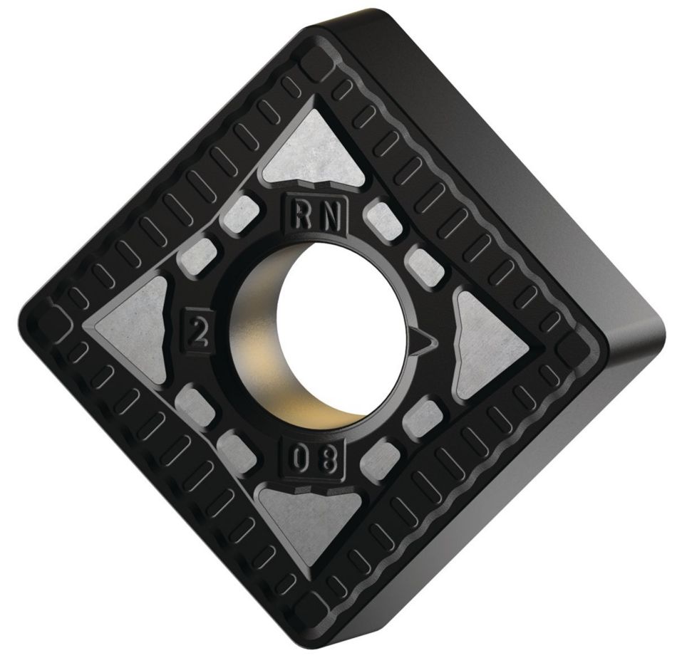

Kenloc™ • SNMG Insert • Negative • RN
ISO Turning Carbide Insert • Roughing Negative Geometry
Material Number3753321
ISO Catalog IDSNMG150608RNANSI Catalog IDSNMG542RN
Kenloc™ SNMG ISO/ANSI Turning Insert 3753321 - Kennametal
GradeKCP10
[D] Insert IC Size15.875 mm
[D] Insert IC Size0.625 in
[L10] Insert Cutting Edge Length15.875 mm
[L10] Insert Cutting Edge Length0.625 in
[S] Insert Thickness6.35 mm
[S] Insert Thickness0.25 in
[Rε] Corner Radius 0.8 mm
[Rε] Corner Radius 0.031 in
[D1] Insert Hole Size 6.35 mm
[D1] Insert Hole Size 0.25 in
KCP10
KCP10
Composition: A specially engineered cobalt-enriched carbide grade with thick MTCVD-TiCN-Al2O3 coating for maximum wear resistance.
  • Roughing geometry with stronger edge line for demanding applications
