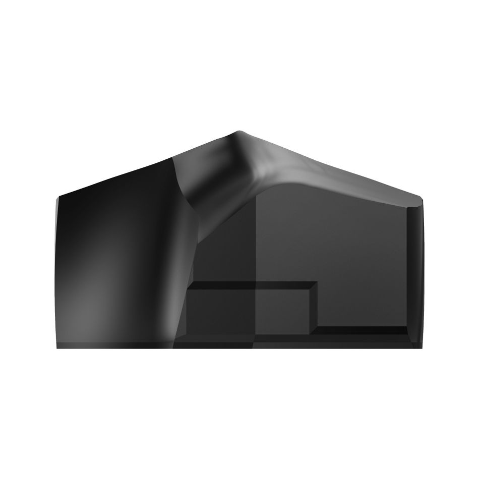

KSEM™ • Center Insert • HPG Geometry
Modular Drilling • Carbide Insert for KSEM™
Material Number5397487
ISO Catalog IDKSEM2223HPGMANSI Catalog IDKSEM0875HPG
GradeKCPM45
[D1] Drill Diameter 22.23 mm
[D1] Drill Diameter 0.8752 in
[L5] Drill Point Length3.91 mm
[L5] Drill Point Length0.154 in
[SSC] Insert Seat Size4

KCPM45
KCPM45
Composition: Multilayered PVD TiN-TiAlN coated medium-grain carbide.
Application: Applicable for steel and cast iron. This grade offers excellent wear resistance and reliability at intermediate cutting speeds. Due to the medium-grain carbide, it offers superior chipping resistance in metastable machining conditions.
  • HPG geometry for modular drilling in alloyed steels
  • With straight cutting edge for maximum stability in short chipping steels and interrupted cuts
