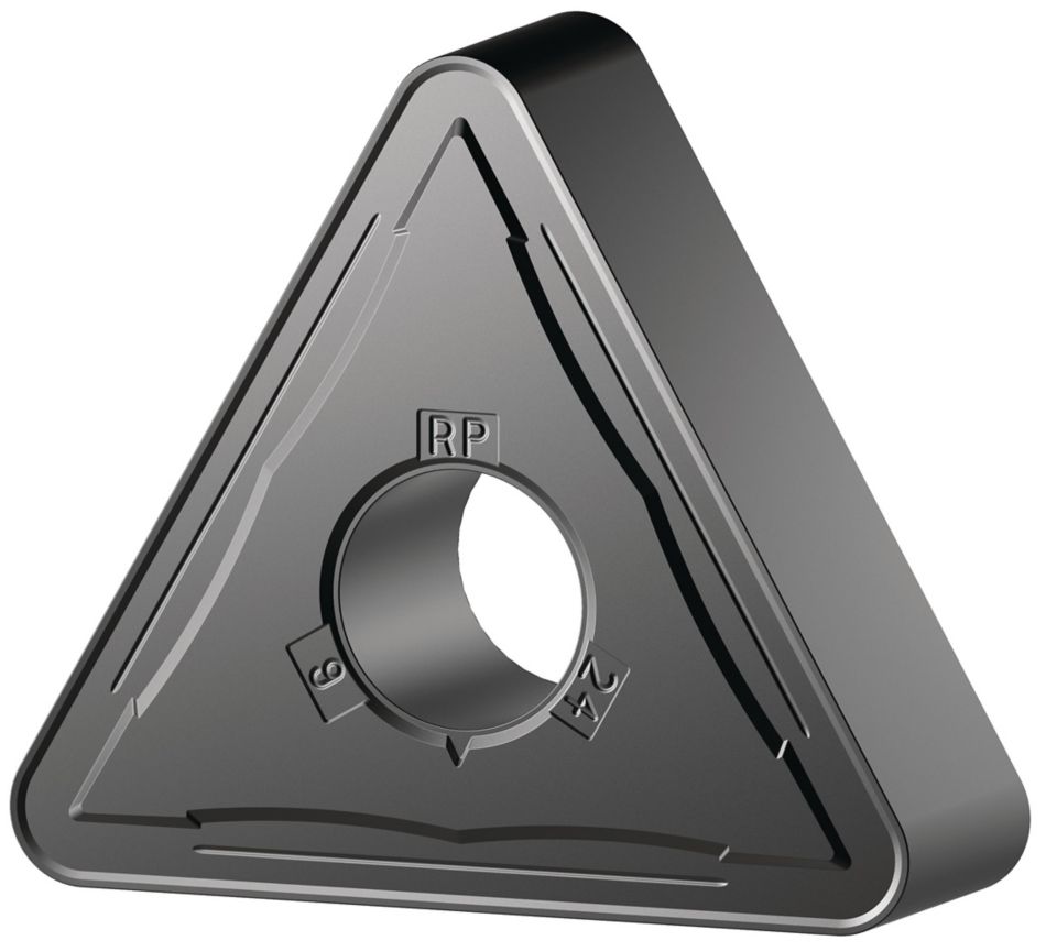

Kenloc™ • TNMG Insert • Negative • RP
ISO Turning Carbide Insert • Roughing Positive Geometry
Material Number1864885
ISO Catalog IDTNMG160408RPANSI Catalog IDTNMG332RP
Kenloc™ TNMG ISO/ANSI Turning Insert 1864885 - Kennametal
    Drawings for 1864885
    GradeKC9245
    [D] Insert IC Size9.525 mm
    [D] Insert IC Size0.375 in
    [L10] Insert Cutting Edge Length16.498 mm
    [L10] Insert Cutting Edge Length0.6495 in
    [S] Insert Thickness4.763 mm
    [S] Insert Thickness0.1875 in
    [Rε] Corner Radius 0.8 mm
    [Rε] Corner Radius 0.031 in
    [D1] Insert Hole Size 3.81 mm
    [D1] Insert Hole Size 0.15 in
    KC9245
    composition: A multi-layered MTCVD coating over a super-tough
    substrate.
    application: This MTCVD coated carbide grade is engineered to take on
    the most brutal cast stainless steel machining applications. Its substrate
    withstands heavy interruptions, while its polished surface resists build-up,
    even at slow cutting speeds. Additionally, its wear-resistant coating
    resists the micro-chipping common when machining austenitic stainless
    steel. The KC9245 grade is also available in insert sizes and geometries
    appropriate for heavy feeds and large depths-of-cut.
    • Roughing geometry with positive rake face for chip control in difficult materials
