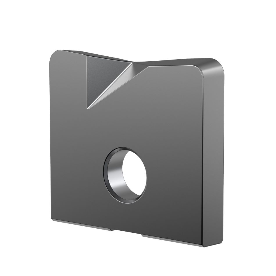

Insertos para KDMT • KDMS-GN
Insertos intercambiáveis • KDMS... • KDMT...
Número de material6784128
ID do catálogo ISOKDMS1210ERGNID do catálogo ASIKDMS1210ERGN
- P Steel
- M Stainless Steel
- K Cast Iron
- H Hardened Materials
| Número de material | 6784128 |
| ID do catálogo ISO | KDMS1210ERGN |
| ID do catálogo ASI | KDMS1210ERGN |
| Grade | KCPK10 |
| [LI] Insert Length | 14 mm |
| [LI] Insert Length | 0.551 in |
| [S] Insert Thickness | 2.5 mm |
| [S] Insert Thickness | 0.0984 in |
| [W] Cutting Width | 12 mm |
| [W] Cutting Width | 0.4724 in |
| [RR] Corner Radius | 1 mm |
| [RR] Corner Radius | 0.039 in |
| Average Chip Thickness [HM] | 0.08 mm |
| Average Chip Thickness [HM] | 0.0003 in |
