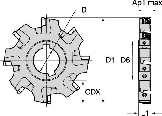

KSSM™ 12 • Slot Mill with Arbor Mount • Adjustable Cutting Width up to 18mm • Right Hand Cutting • Metric
Slot milling cutter for side milling in multiple materials
Número de material104202371
- Unique cam adjustment mechanism enables quick tool setting and cutting width adjustment.
- Cutter body features two keyways for staggered arbor mounting.
- Use right-hand and left-hand inserts for best possible wall surface finish.
